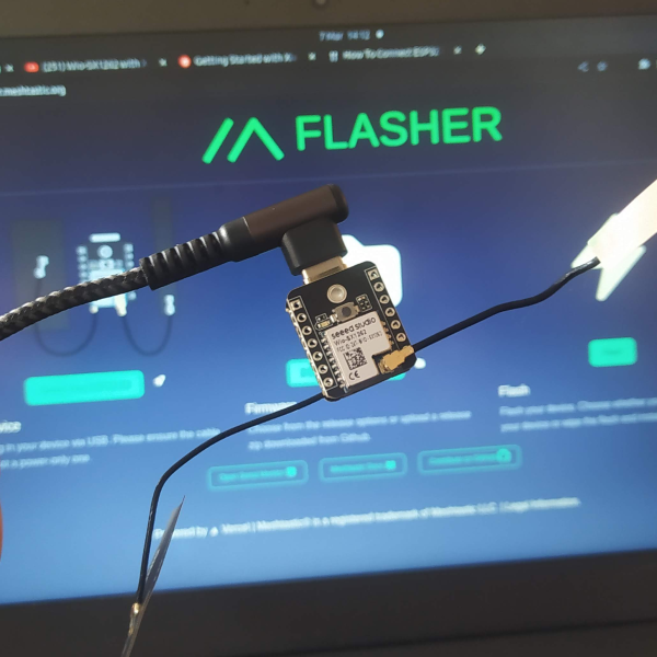

The diminutive kit, which consists of a microcontroller and a LoRa module, has actually been available from the usual outlets for a while. But [concretedog] has been deep in the Meshtastic weeds lately, and decided to review its pros and cons. Setup starts with flashing Meshtastic to the XIAO ESP32-S3 microcontroller and connecting the included BLE antenna. After that, the Wio-SX1262 LoRa module is snapped to the microcontroller board via surface-mount connectors, and a separate LoRa antenna is connected. Flash the firmware (this combo is supported by the official web flasher), and you’re good to go.

  2. That node is a power hog compared to the NRF52 chip used in devices like the RAK wisblock and heltec t114. It works great if you have USB power available but not a great if you plan to run it off a battery. Either way, $10 to get started with meshtastic is a deal.
    1. They have a Xiao packaged nrf52 chip that comes with the sx1262 radio bundle as well I think it’s 15 instead of 10 dollars us
    1. Display works on mine fine. I have my Xiao in the expansion board ,with a grove keyboard attached, works well as a DIY T-Deck.
