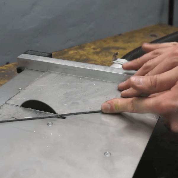

If you want a regular table saw, you’re probably best off just buying one—it’s hard to beat the economies of scale that benefit the major manufacturers. If you want a teeny one, though, you might like to build it yourself. [Maciej Nowak] has done just that.
The concept is simple enough; a small motor and a small blade make a small table saw. [Maciej] sourced a remarkably powerful 800-watt brushless motor for the build. From there, the project involved fabricating a suitable blade mount, belt drive, and frame for the tool. Some time was well-spent on the lathe producing the requisite components out of steel and aluminum, as well as a stout housing out of plywood. The motor was then fitted with a speed controller, with the slight inconvenience that it’s a hobby unit designed to run off DC batteries rather than a wall supply. Ultimately, though, this makes the saw nicely portable. All that was left to do was to fit the metal top plate, guides, and a suitably small 3″ saw blade to complete the build.

If you zoom in on the title photo, what happens between left thumb and index?
It looks like he has his right thumb tucked in there, that’s all.

Great build, but as that is still a serious blade with plenty of torque behind it and some heavier feedstock (the aluminum) shown, there should really really really be a riving knife.
In my many years experience with a table saw, the riving knife, one-way pawls and blade cover have all caused more injuries and damaged stock than a naked saw. It’s dangerous, sure, but a drill press is a far more injurious machine.
I agree. I have a lot more respect for my table saw because it doesn’t have any safety features. I go through a meticulous process every time I use it to make sure I don’t get hurt.

If the saw is strong enough to move the piece, it is strong enough to drag your wayward appendage past the blade faster than you can regret it. A riving knife helps stop the material from closing up behind the blade, which makes it harder for it to lift and drag the piece. If you’re working with pieces this small, just acquire a benchtop jig saw. The vertical cuts will be cleaner anyhow, due to smaller workface and no horizontal actions.
