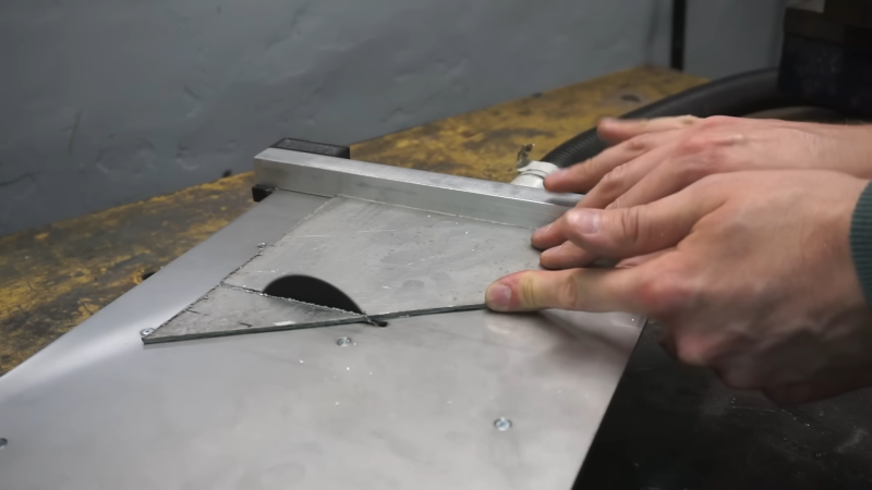

If you want a regular table saw, you’re probably best off just buying one—it’s hard to beat the economies of scale that benefit the major manufacturers. If you want a teeny one, though, you might like to build it yourself. [Maciej Nowak] has done just that.
The concept is simple enough; a small motor and a small blade make a small table saw. [Maciej] sourced a remarkably powerful 800-watt brushless motor for the build. From there, the project involved fabricating a suitable blade mount, belt drive, and frame for the tool. Some time was well-spent on the lathe producing the requisite components out of steel and aluminum, as well as a stout housing out of plywood. The motor was then fitted with a speed controller, with the slight inconvenience that it’s a hobby unit designed to run off DC batteries rather than a wall supply. Ultimately, though, this makes the saw nicely portable. All that was left to do was to fit the metal top plate, guides, and a suitably small 3″ saw blade to complete the build.
