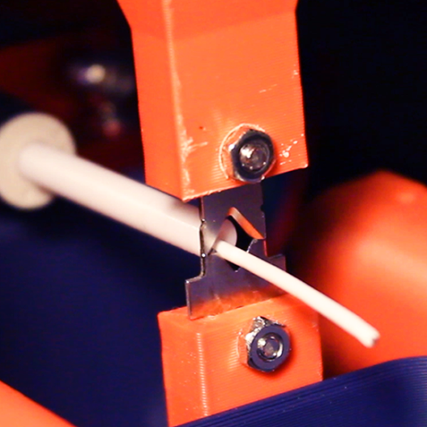

Stripping and cutting wires can be a tedious and repetitive part of your project. To save time in this regard, [Red] built an automatic stripper and cutter to do the tiring work for him.
An ESP32 runs the show in this build. Via a set of A4988 stepper motor drivers, it controls two NEMA 17 stepper motors which control the motion of the cutting and stripping blades via threaded rods. A third stepper controls a 3D printer extruder to move wires through the device. There’s a rotary encoder with a button for controlling the device, with cutting and stripping settings shown on a small OLED display. It graphically represents the wire for stripping, so you can select the length of the wire and how much insulation you want stripped off each end. You merely need select the measurements on the display, press a button, and the machine strips and cuts the wire for you. The wires end up in a tidy little 3D-printed bin for collection.

It may take quite a few wires to save the time, but also the strippers tend to be able to be calibrated to not cut into the metal of the wire which is something more difficult to do repeatedly with hand tools.

Maybe slightly raise the blades and to a pullback. This will at least on one side already remove the isolation.
For the smaller lengths, you could even do the other side. Strip it at 2 cm. Then make the indent on the other side and slide the isolation 1 cm with a pullback.

Crazy project, looking forward to a MK2 version. Ideally you would want to see a single stepper for the cutter, I am sure you could put the other end on a pivot and it would work.
Could you use nichrome wire instead of blades to cut? Would that be better for stranded wire?

anyone have a source for the blades he used?
I’ve been noodling on building one of these as well, some of my projects become production and stripping so many wires is definitely a bore.
His design is better and simpler than what I had in mind which makes it considerably more feasible.
Could probably hack it with blades from an industrial machine. They are often sold as spares. Looks very similar to the blades for the Eubanks machine I have…but they are spendy https://www.amazon.com/Eubanks-9800-Universal-Stripping-Blades/dp/B0CB9227L7
But I was looking at Xacto #16 blades and I bet you could use 2 of them and make a pretty nice adjustable width…assuming you don’t mind the slight offset. Which is similar to the Schleuniger 2100 Unistrip https://youtu.be/OJwZQ0eJh2U
search for “Knipex 12 69 21”
Thank you!!
I just did a quick search on AliExpress for “Wire Stripper Blades” and found some similar, so doing the same might give you some keywords for your favorite parts shopping platform (one I can remember was V Blades, but searching for that wasn’t so helpful, I got all sorts of other less useful things instead).
