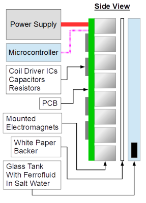

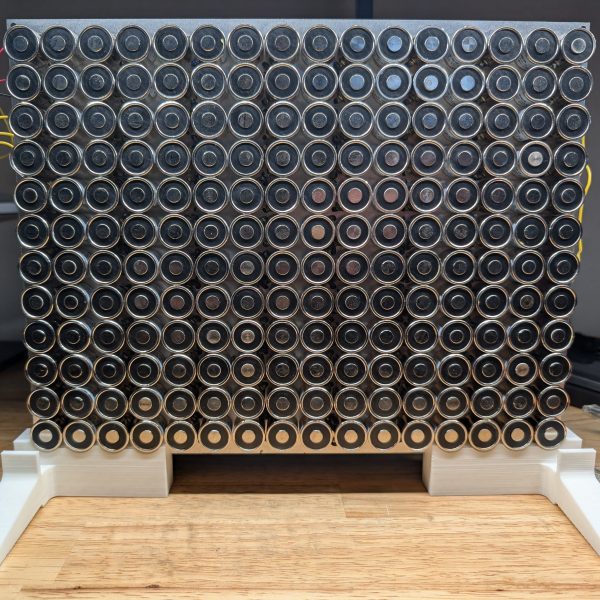

The concept is straightforward enough. First, construct a tank of ferrofluid with a white panel behind it for contrast. Then, place it in front of a grid of electromagnets. Now you have many “pixels” you can turn on and off. You turn a magnet on to attract ferrofluid to that point, and turn it off to let it fall away. Since the ferrofluid contrasts with the white background, you have a viable display!
[beastie417] notes that while the concept is simple, the execution is hard. Ferrofluid can be very difficult to work with, instantly staining many materials like acrylic and even glass that isn’t properly prepared. It can also be quite expensive to construct a display like this, with [beastie417] noting their 16×12 pixel design costing approximately $700 thus far. Then you have to figure out how to drive all the pixels—this project uses DRV8908 coil driver ICs running off a microcontroller which controls the display and handles animations.

I am curious to see the power requirements of driving this display. Using magnets mounted on some kind of linear actuator might reduce the power draw, and potentially cost as well.
The power requirements are quite large though it depends on how many simultaneous dots are driven. A linear actuator or gantry could work but you are then limited to displaying a single dot and would be a very different kind of display. See the demo videos below

I was thinking the suggestion was to have every magnet/pixel on a linear actuator, which moves the magnet closer or further away from the display/tank.
