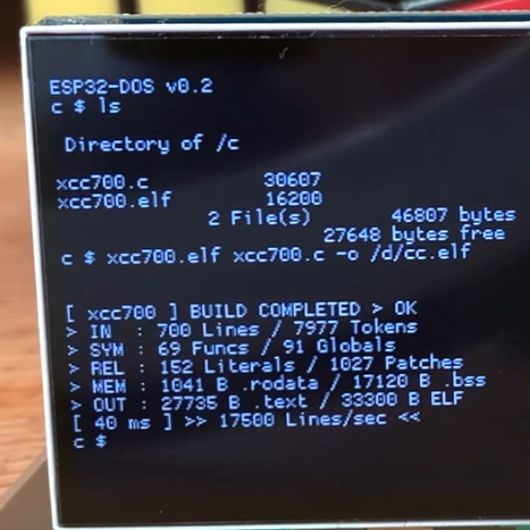

With two cores at 240 MHz and about 8.5 MB of non-banked RAM if you’re using the right ESP32-S3 version, this MCU seems at least in terms of specifications to be quite the mini PC. Obviously this means that it should be capable of self-hosting its compiler, which is exactly what [Valentyn Danylchuk] did with the xcc700 C compiler project.
Targeting the Xtensa Lx7 ISA of the ESP32-S3, this is a minimal C compiler that outputs relocatable ELF binaries. These binaries can subsequently be run with for example the ESP-IDF-based elf_loader component. Obviously, this is best done on an ESP32 platform that has PSRAM, unless your binary fits within the few hundred kB that’s left after all the housekeeping and communication stacks are loaded.
The xcc700 compiler is currently very minimalistic, omitting more complex loop types as well as long and floating point types, for starters. There’s no optimization of the final code either, but considering that it’s 700 lines of code just for a PoC, there seems to be still plenty of room for improvement.

  4. Self hosting a C-compiler is nice, but it has to live in an environment too. I see “ESP32-DOS” on the TFT, and there is an older article on hackaday for that: https://hackaday.com/2021/07/28/emulating-the-ibm-pc-on-an-esp32/ You’d also need a text editor to input the source code, and a generic (preferably multi tasking ) OS to start your programs would then be a logical choice. What’s up with that “elf loader”? If this works over a terminal (emulator (telnet / netcat)) that would be nice too, and drivers for the network are normally an OS function too, so multiple programs can use the network stack.
