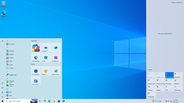

Asking The Right Questions
The Windows 10 desktop. (Source: Microsoft)
Storage and RAM requirements for software are linked in the sense that much of an application’s code and related resources are loaded into RAM at some point, but there is also the part of RAM that gets filled with data that the application generates while running. This gives us a lens to find out where the higher requirements come from.
In the case of Windows, the increase in minimum storage space requirements from 1 GB to 32 GB for Windows 10 can be explained by something that happened when Windows Vista rolled around along with changes to WinSxS, which is Windows’ implementation of side-by-side assembly.
By putting all core OS files in a single WinSxS folder and hard-linking them to various locations in the file system, all files are kept in a single location, with their own manifest and previous versions kept around for easy rollback. In Windows 2000, WinSxS was not yet used for the whole OS like this, mostly just to prevent ‘DLL Hell’ file duplication issues, but Vista and onwards leaned much more heavily into this approach as they literally dumped every single OS file into this folder.
While that by itself isn’t such an issue, keeping copies of older file versions ensured that with each Windows Update cycle the WinSxS folder grew a little bit more. This was confirmed in a 2008 TechNet blog post, and though really old files are supposed to be culled now, it clearly has ensured that a modern Windows installation grows to far beyond that of pre-Vista OSes.
Thus we have some idea of why disk storage size requirements are increasing, leading us to the next thing, which is  the noticeable increase in binary size. This can be put down for a large part on increased levels of abstractions, both in system programming languages, as well as scripting languages and frameworks.
