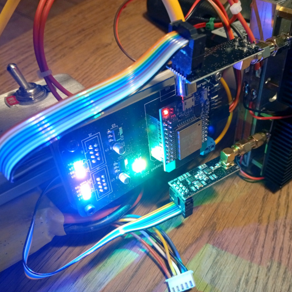

To combat this aural menace, [Tixlegeek] is here with a jammer for the 2.4 GHz spectrum to make annoying Bluetooth devices go silent. While it’s not entirely effective, it’s still of interest for its unashamed jankiness. Besides, you really shouldn’t be using one of these anyway, so it doesn’t really matter how well it works.
Raiding the AliExpress 2.4 GHz parts bin, there’s a set of NRF24L01+ modules that jump around all over the band, a couple of extremely sketchy-looking power amplifiers, and a pair of Yagi antennas. It’s not even remotely legal, and we particularly like the sentence “After running the numbers, I realized it would be cheaper and far more effective to just throw a rock at [the Bluetooth speaker]“. If there’s a lesson here, perhaps it is that effective jamming comes in disrupting the information flow rather than drowning it out.

I note that he doesn’t say whether it did actually jam his neighbour’s speaker. BT can be surprisingly resilient to non-wideband jamming attacks.
Nope, it didn’t. I found the range to be at most 2m 😄

Jammers do have one advantage that he did not mention. Unlike analog, digital protocols do not need to be disrupted continuously. If you’re clever you can desyncronize the receiver and transmitter and they link will be broken for some time, potentially seconds. That means you can focus your power into bursts, and at single frequencies to obtain MUCH higher peak output, even though the average is still low. Alas this does rule out simple “noisy” jammers.
