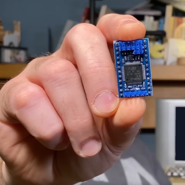

Retrocomputers need ROMs, but they’re just so read only. Enter the latest incarnation of [Piers]’s One ROM to rule them all, now built with a RP2350, because the newest version is 5V capable. This can replace the failing ROMs in your old Commodore gear with this sweet design on a two-layer PCB, using a cheap microcontroller.
[Piers] wanted to use the RP2350 from the beginning but there simply wasn’t space on the board for the 23 level shifters which would have been required. But now that the A4 stepping adds 5 V tolerance [Piers] has been able to reformulate his design.
The C64 in the demo has three different ROMs: the basic ROM, kernel ROM, and character ROM. A single One ROM can emulate all three. The firmware is performance critical, it needs to convert requests on the address pins to results on the data bus just as fast as it can and [Piers] employs a number of tricks to meet these requirements.
The PCB layout for the RP2350 required extensive changes from the larger STM32 in the previous version. Because the RP2350 uses large power and ground pads underneath the IC this area, which was originally used to drop vias to the other side of the board, was no longer available for signal routing. And of course [Piers] is constrained by the size of the board needing to fit in the original form factor used by the C64.

+1. Also, as I say in the video, I don’t think 4 layer helps here – you still can’t route on the top layer due to the RP2350, the middle layers are ground and power, so you’re still stuck with the bottom layer and the vias going through the chip’s ground pad. So you need to go with 6 layers to make your life easier – but it’s unnecessary as I’ve shown.

Well, 5V tolerant but not like this. From the RP2350 data sheet:
Fault Tolerant Digital. These pins are described as Fault Tolerant,
which in this case means that very little current flows into the pin
whilst it is below 3.63 V and IOVDD is 0 V. Additionally, they will
tolerate voltages up to 5.5 V, provided IOVDD is powered to 3.3 V.
Since the 3.3V regulator runs off the 5V in this design there is plenty of time for 5V to fry your GPIOs before the IOVDD is up and stable at 3.3V.
Will it work anyway? Maybe, probably, who knows? It’s not to spec anyway.
It depends greatly on the actual logic levels driving pins on the ROM. Most TTL IC datasheets show logic high as 3.4-ish volts or less, depending on the specific family. Pull-ups and hard-wired pins might be an issue, but in practice even the old 2340 put up with a fair amount of abuse.
I wouldn’t build and sell this design by the thousands, but as a hobbyist-level retro-computing tool, it’s pretty awesome.
Agree. .As you say, this isn’t the most robust solution – the other related issue is that the abs max voltage on the RP2350 is 5.5V. Those old ICs, and the STM32 which I already have a solution based on, has an abs max voltage up to >7V. So, one dodgy voltage regulator and …
On the other hand, I haven’t fried an RP2350 yet, and I’ve done quite a lot of testing, including for example as the C64 char ROM, which has one of the CS lines permanently pulled to 5V. Maybe I’m damaging the GPIO pads a brief instant at a time, and it’ll catch up with me.
It’s highly likely that other manufacturer’s microcontrollers with 5v-tolerant inputs have exactly the same restrictions, but the manufacturer doesn’t bother to mention it. And yet they’re still routinely used in such applications without problems. The “fault tolerant” mechanism relies on IOVDD to prevent current flow into the pin at 5V, but it’s not the only mechanism present. These pins all have ESD protection diodes present for transient voltage spikes far above 5V, and they’ll also protect the pin – they just do it by conducting to the rail, so the “low current flow into the pin” feature is not present, but the pin is still protected.
Unless you have actual evidence that there’s any real risk of damage in normal use, you’re just making up reasons to rag on a product you don’t like.
As it is, even the RP2040 has similar behaviour, just not “officially” (because Raspberry Pi did not spend the money to validate it), and I’ve used them in 5v systems with zero issues.
