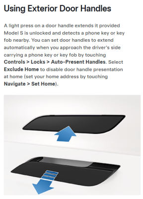

A number of automakers have developed fancy retractable door handles in recent years. They are most notably seen on electric vehicles, where they are stated to have a small but measurable aerodynamic benefit. They are often paired with buttons or other similar electronic controls to open the doors from the inside. Compared to mechanical door handles, however, these door handles come with a trade-off in complexity. They require electricity, motors, and a functioning control system to work. When all is well, this isn’t a problem. However, when things go wrong, a retractable electronic door handle often proves inaccessible and useless.

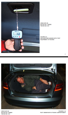

US regulations mandate highly-visible emergency trunk release handles that are easily activated. However, obvious mechanical backups have not been required for cars fitted with electronic door handles. Credit: NHTSA
It’s worth noting that in the US market, federal regulations have mandated glow-in-the-dark trunk releases be fitted to all sedans from the 2002 model year onwards. You could theoretically escape from the trunk of certain Teslas more easily than a Cybertruck or Model 3 with a failed electrical system.

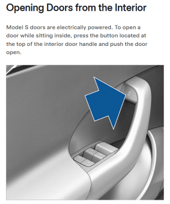

Meanwhile, despite the obvious risks, electronic door handles have faced no major regulatory challenges. There were no obvious written rules standing in the way of Tesla making the choice to eliminate regular old door handles. Nor were there strict regulations on emergency door releases for passengers inside the vehicle. Tesla spent years building several models with no mechanical door release for the rear passengers. If your door button failed, you’d have to attempt escape by climbing out through the front doors, assuming you could figure out how to open them. Even today, the models with mechanical door releases still often hide them behind interior trim pieces or carpets, where few passengers would ever think to look in an emergency.
Try explaining this to someone in the back seat while the car is burning around you. Credit: Tesla

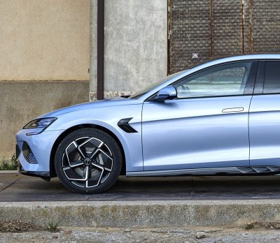

Flush door handles have become popular with Chinese automakers like BYD and Geely. However, these door handles require the vehicle’s electrical supply to be intact in order to work. Credit: BYD

  2. Although I found that image of the person in the trunk slightly disturbing, I could not help wondering if there still is enough room left for some lengthy piece of rope, a roll of tape, a large plastic sheet, a medium size chainsaw and a shovel? And does anyone know if this car model has an easy way of preventing the trunk from being opened from the inside? Just curious.
