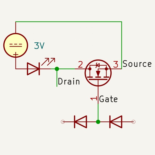

Over on YouTube our hacker [VIP Love Secretary] shows us how to make a simple MOSFET tester.
This is a really neat, useful, elegant, and simple hack, but the video is kind of terrible. We found that the voice-over constantly saying “right?” and “look!” seriously drove us to distraction. But this is a circuit which you should know about so maybe do what we did and watch the video with subtitles on and audio off.
To use this circuit you install the MOSFET you want to test and then press with your finger the spare leg of each of two diodes; in the final build there are some metal touch pads attached to the diodes to facilitate this. One diode will turn the MOSFET off, the other diode will turn the MOSFET on, and the LED will show you which is which.
Apparently this works through stray capacitance, an explanation which makes sense to us. We were so curious that we ran over to the bench to build our own version (pictured with the schematic above) just to see if it worked as advertised, and: it did!
We tested it with a faulty MOSFET and when the MOSFET under test is faulty then the LED won’t turn on and off like it should when the MOSFET works. Also, if you build one of these, you want to feed in a two or three volt supply (it will depend on the specs of the LED you use); it’s not mentioned in the video but two volts is what we used that worked best for us.
Thanks to [Danjovic] for writing in to let us know about this one. If you’re interested in MOSFETs maybe it’s time to learn the truth about them.
Nice video. A better explanation is that the stray capacitance of the high-impedance gate should retain whatever charge is imparted upon it to keep the LED turned on or off. The human acts as an antenna for lots of stray EMF and the diodes are acting as peak detectors for the antenna voltage. Touching the cathode drags the gate down to the peak negative voltage (minus the diode drop), while touching the anode raises the gate up to the peak positive voltage (again, minus the diode drop).
Be cautious using this as ESD from touching the diodes could destroy your MOSFET. If you add a ~10V zener diode from gate to source, it’ll protect it without affecting the tester functionality.
Agree, but a typical zener will do little to protect against ESD; and many MOSFET gates can blown to smitthereens by HBM ESD.
Oh, bummer. Is there anything to be done to make this circuit work safely?
A series resistor – zener shunt to source – series resistor – gate configuration is pretty robust, and this application is so insensitive to turn-on/turn-off time that you don’t have to think much about picking resistors. Grab something in the kiloohms, and make the first resistor something with a decent voltage rating (if you have no datasheets because you’re fishing around the junk box, physically larger resistors are usually better).
Junk box parts and haphazard layout won’t be perfect, and if you scuff your feet across the carpet enough or stand up from a fabric chair fast enough you will still be able to kill your FETs, but a circuit like that will be fine if you exercise even a tiny bit of care.

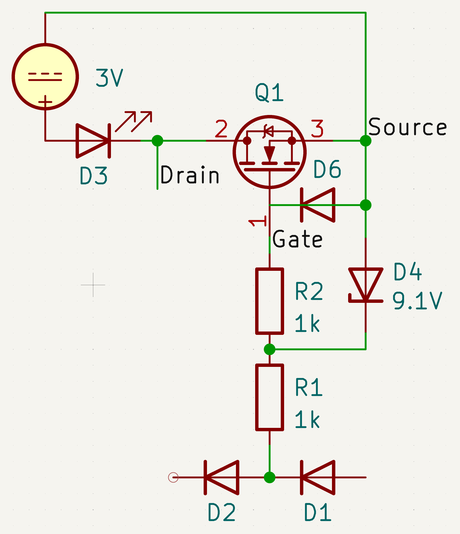

FYI the circuit I plan to implement next is this one. I would be happy to have any feedback on it! Thanks! https://www.inthelabwithjayjay.com/file/2025-09-14-235202/MOSFET-tester-2025-09-14-235154.png
You can remove D6 (Zener can also conduct)
You have also drawn a wire though D6. It’s shorted now.
Remove R1 (Why use two resistors?)
Increase R1 to 100k to a few Mega Ohm (You only have to charge the gate capacitance)
And as I wrote in that other post, TVS diodes are better, because they react faster. But with a 100k or more series resistor, the RC time (with the gate capacitance) is probably more then the reaction time of the zener.
Also, the usage of the Diodes implies that you pick up noise (If I touch my scope probe, I can often see >80V mains voltage hum.
A variant of this circuit: touch the gate with one finger, and then alternately touch GND or the 12V power supply. Your body will conduct enough to turn the FET on or off. (For this the power supply needs to be higher then the gate voltage).
This also works with darlington transistors, you may have to add a 3rd BJT for more amplification of the picked up noise.

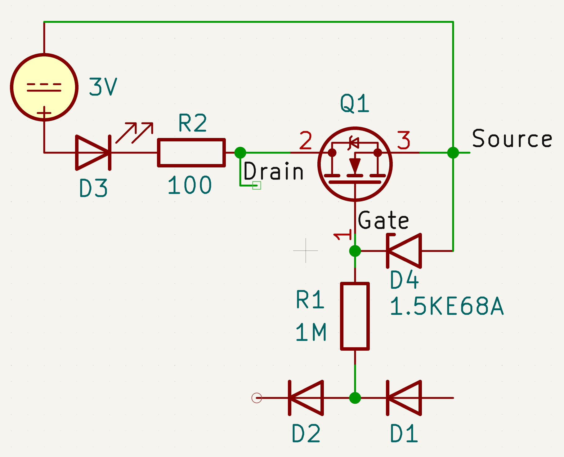

Thanks paulvdh. The latest circuit revision can be found at the following link. I assume I want a unidirectional TVS diode and not a bidirectional one? Will a 6.8V TVS diode suffice? https://www.inthelabwithjayjay.com/file/2025-09-15-023319/MOSFET-tester-2025-09-15-023308.png
Thanks for the tip! I have some 9.1V Zeners on hand, will one of those do?
Don’t use regular zeners, but use TVS diodes.
In a class at school they were troubled by a lot of blown FET’s (Used on breadboards), so they started soldering TVS diodes directly from Gate to Drain.
Most FET’s have their threshold voltage around 4V and 9V is enough In that class they used something like 16V or 18V TVS diodes. It interferes less with the gate driver, while still being below the (most often 20V allowable gate voltage. (Some high power fets have a 30V gate voltage these days). For small signal fets, it can be less.
