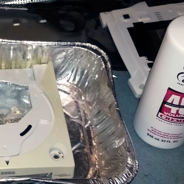

After a decade of trying out various retrobrighting methods, he found for example that a Sega Dreamcast shell which he treated with hydrogen peroxide ten years ago actually yellowed faster than the untreated plastic right beside it. Similarly, the use of ozone as another way to achieve the oxidation of the brominated flame retardants that are said to underlie the yellowing was also attempted, with highly dubious results.
While streaking after retrobrighting with hydrogen peroxide can be attributed to an uneven application of the compound, there are many reports of the treatment damaging the plastics and making it brittle. Considering the uneven yellowing of e.g. Super Nintendo consoles, the cause of the yellowing is also not just photo-oxidation caused by UV exposure, but seems to be related to heat exposure and the exact amount of flame retardants mixed in with the plastic, as well as potentially general degradation of the plastic’s polymers.
Pending more research on the topic, the use of retrobrighting should perhaps not be banished completely. But considering the damage that we may be doing to potentially historical artifacts, it would behoove us to at least take a step or two back and consider the urgency of retrobrighting today instead of in the future with a better understanding of the implications.

    1. I forgot to mention: I use standard drugstore 3% H2O2, not the stronger hair bleach type, but I have a fairly powerful UV source, originally designed to cure sealants for automotive applications, which I use in short bursts. The only bad thing that happened was when I accidentally forgot about my SNES mouse shell, which is now bleached almost white. It is still not brittle, however.
      1. This everyone i have seen that has bad results (either immediately or eventually) uses weapons grade creme, applies it unevenly as possible, then scrunches the mess in plastic wrap.
        Uneven application using the strongest stuff you can get leads to uneven results.
        A few quarts of drug store liquid a scoop of oxygen clean top off with water is really all it takes (and some uv i used to do it in the spring time and just used the mild sun)

      1. The “UV clear coat” idea was already debunked years ago, because that’s not what causes the new yellowing.
        The problem is that retrobriting is purely a surface process, but the yellowing is a volume process. The free bromine that’s causing the yellowing is mostly created at the surface but it diffuses deeper into the plastic over time, with it happening faster at higher temperatures. You then take that plastic with it’s deeply buried bromine and quickly treat the bit at the top to make it white again.
        What do you think happens in the following few years? Any free bromine that’s still below the surface will slowly diffuse back out, regardless of whether it’s kept in the dark or not! If you were particularly uneven or vigorous with your retrobriting, then you might have variations in the amount of bromine that is stripped from the surface which looks fine initially, but becomes more obvious as the bromine starts to diffuse back out at different rates.
        The real trick with retrobriting is that less is more (regardless of the method, peroxide or more UV exposure). You want an even, light treatment that doesn’t necessarily bring it all the way back but also doesn’t damage the plastic much, and then you need to repeat the process every few years as more bromine works it’s way out.

    1. That is exactly what the video shows: multiple kinds of damage on places that were treated, and both reduced re-yellowing as well as no other cosmetic damage on places that were protected from the bleach a decade ago.
    2. Specifically, the best example is on the bottom. He taped over the bottom label, but the tape was large and covered some of the plastic too. Today, the plastic that was protected by the tape from retrobrighting is less yellow than the retrobrighted plastic right next to it. On the same plastic, on the same surface, in spots 1cm from each other.
