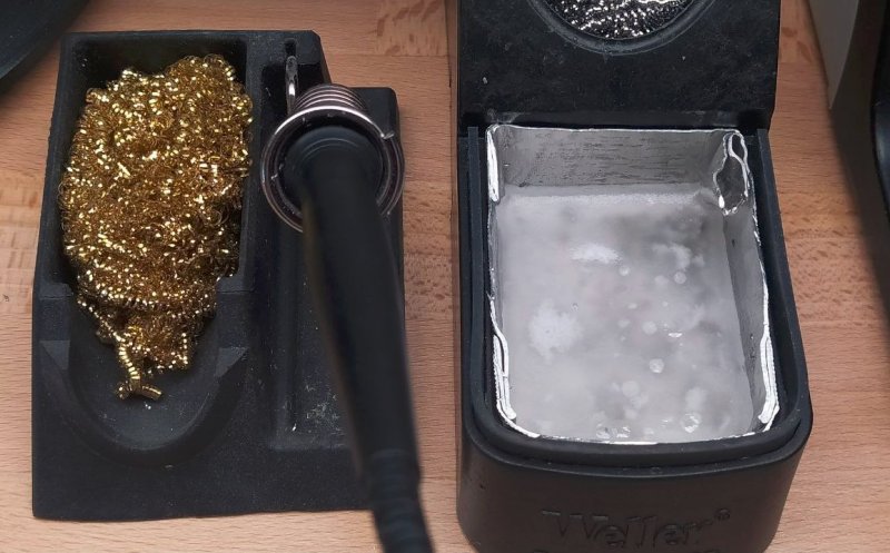

Have you ever tipped all the stray bits of solder out of your tip cleaner by mistake? [MisterHW] is here with a bit of paraffin wax to save the day.
Hand soldering can be a messy business, especially when you wipe the soldering iron tip on those common brass wool bundles that have largely come to replace moist sponges. The Weller Dry Cleaner (WDC) is one of such holders for brass wool, but the large tray in front of the opening with the brass wool has confused many as to its exact purposes. In short, it’s there so that you can slap the iron against the side to flick contaminants and excess solder off the tip.
Along with catching some of the bits of mostly solder that fly off during cleaning in the brass wool section, quite a lot of debris can be collected this way. Yet as many can attest to, it’s quite easy to flip over brass wool holders and have these bits go flying everywhere.
The trap in action. (Credit: MisterHW)
That’s where [MisterHW]’s pit of particulate holding comes into play, using folded sheet metal and some wax (e.g. paraffin) to create a trap that serves to catch any debris that enters it and smother it in the wax. To reset the trap, simply heat it up with e.g. the iron and you’ll regain a nice fresh surface to capture the next batch of crud.
As the wax is cold when in use, even if you were to tip the holder over, it should not go careening all over your ESD-safe work surface and any parts on it, and the wax can be filtered if needed to remove the particulates. When using leaded solder alloys, this  setup also helps to prevent lead-contamination of the area and generally eases clean-up as bumping or tipping a soldering iron stand no longer means weeks, months or years of accumulations scooting off everywhere.

  4. Please don’t bang soldering iron on anything unless you are trying to kill the heater. Any blob that can be banged off can just as easily be wiped off on the brass wool. I believe the real purpose of the metal well is to hold a sponge or a tin of flux. The banged up edge of the well are a good indication that it is not the intended purpose.

  6. Allow me to provide a little more background.
    It’s fair to make assumptions based purely on the information given in this article.
    However, I do quite enjoy revisiting project documentation to update it, as I’ve done this time in the third year of using this item. That and not having damaged a single heater in over 20 years should serve as a data point that it’s reasonably safe to remove solder by bumping the tip against a soft edge.
    The lip inserted into the edge of the WDC is made of high temperature elastomer, probably silicone. You’re not supposed to hit the plastic.
    I bought that WDC used, with all the scratches and blemishes on the plastic. It’s a hack and I was cheap.
    The state of the metal insert.. I hope it’s clear that there are marks from me forming the sheet metal, both outside, and for some corrections while inserted into the plastic part.
    AlMg3 is pretty soft, but not THAT soft.
    None of the marks on the metal were caused by a soldering iron.
    The auto-ignition temperature of paraffin wax is 245C to 340C, and the soldering iron is at ~350C.
    I’m not sure I understand that one. I should have mentioned though that to reset the trap, the soldering iron isn’t set to soldering temperature, but far lower, something like 150°C. Due to the limited contact of the tip and the metal, the heat is just enough to eventually melt the wax. The plastic is not affected, nor does the temperature of the wax go anywhere near its auto-ignition temperature.
