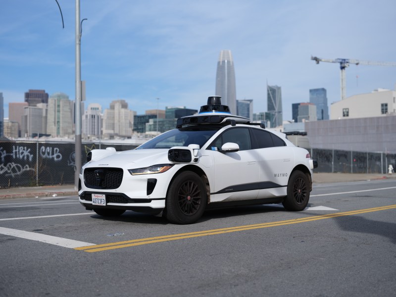

Compared to the considerably less crash-prone Level 4 Waymo cars with their hard to miss sensor packages strapped to the car, one could conceivably make the case that perhaps just a couple of RGB cameras is not enough for reliable object detection, and that quite possibly blending of sensors is a more reliable method for object detection.
Which is not to say that Waymo cars are perfect, of course. In 2024 one Waymo car managed to hit a utility pole at low speeds during a pullover maneuver, when the car’s firmware incorrectly assessed its response to a situation where a ‘pole-like object’ was present, but without a hard edge between said pole and the road.

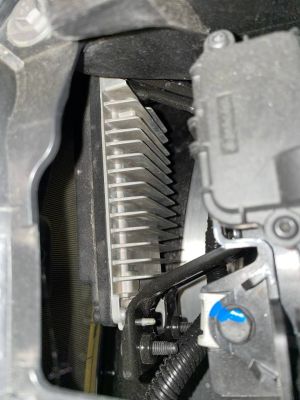

One of the poorly kept secrets about Tesla’s Autopilot system is that it’s had a front-facing radar sensor for most of the time. Starting with Hardware 1 (HW1), it featured a single front-facing camera behind the top of the windshield and a radar behind the lower grille, in addition to 12 ultrasonic sensors around the vehicle.
Notable is that Tesla did not initially use the radar in a primary object detection role here, meaning that object detection and emergency stop functionality was performed using the RGB cameras. This changed after the RGB camera system failed to notice a white trailer against a bright sky, resulting in a spectacular crash. The subsequent firmware update gave the radar system the same role as the camera system, which likely would have prevented that particular crash.

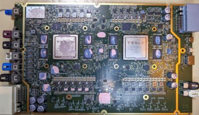

HW1 used Mobileye’s EyeQ3, but after Mobileye cut ties with Tesla, NVidia’s Drive PX 2 was used instead for HW2. This upped the number of cameras to eight, providing a surround view of the car’s surroundings, with a similar forward-facing radar. After an intermedia HW2.5 revision, HW3 was the first to use a custom processor, featuring twelve Arm Cortex-A72 cores clocked at 2.6 GHz.
HW3 initially also had a radar sensor, but in 2021 this was eliminated with the ‘Tesla Vision’ system, which resulted in a significant uptick in crashes. In 2022 it was announced that the ultrasonic sensors for short-range object detection would be removed as well.
Then in January of 2023 HW4 started shipping, with even more impressive computing specs and 5 MP cameras instead of the previous 1.2 MP ones. This revision also reintroduced the forward-facing radar, apparently the Arbe Phoenix radar with a 300 meter range, but not in the Model Y. This indicates that RGB camera-only perception is still the primary mode for Tesla cars.
