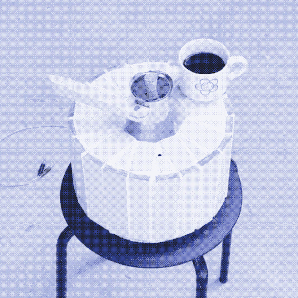

The folks at Low Tech Magazine are here again, this time with a solar powered coffee maker. Lest you think of a large parabolic mirror with a pot at its focus, in this case the device is much more friendly. It’s a table-top appliance that relies upon a 100 W, 12 V panel for its operation.
They make the point that an electric coffee pot requires at least 300 W to work, so what’s the secret? In this case, insulation, as a standard moka pot is placed within a nichrome heating element set in mortar and surrounded by cork. On the outside are tiles, though they appear largely ornamental and the write-up suggests you could experiment with other materials to serve as an enclosure.
It appears to be an effective coffee maker, with the significant caveat that it’s hardly fast. In full sunlight the first pot takes over an hour to brew, with subsequent ones once it’s up to temperature being somewhat faster. But you can’t argue with the idea of free power, even if your favourite caffeinated beverage may now take a while to appear.
We like this idea, despite its slow brewing. We’ve featured Low Tech Magazine before, not least in their solar powered oven.

  2. In a perfect world with a solar panel that doesn’t have loss and a perfect insulation, it would take 8 minutes and 22 seconds, based on a 3 cup (150ml) mokka pot and the 100W panel.
    With a warm mortar slab, which is mentioned, it takes 20 minutes. It’s only the first one that takes over an hour. Now, 20 minutes vs 8 minutes, with a solar panel that won’t be 100% effective, that’s actually pretty reasonable.
    The two biggest improvements I can find are, covering the top and a much better insulation. Quality ceramic fiber blankets for example, with an outer coating for the fibers. Make a cover on it to cover the top and that solar panel might be able to produce coffee much faster. It’s also generally advised to start out brewing with hot water, reducing the time even more.

    The energy to boil a cup (150 ml) of coffee in a kettle is about 15 Watt-hours. The faster you do it, the more efficient it will be. With a US-average electricity price at 12 c/kWh that’s roughly 0.2 cents a cup. To cover the $150 for the panel, you’d have to brew 75,000 cups of coffee.
    Six cups a day, you’ll be at it for 34 years.

        Their device is actually very inefficient, because it needlessly heats up a bunch of thermal mass around the pot. It’s got a resistive heater that is not matched to the panel with any sort of regulator or power tracker, and their only point is to make an RV style coffee maker work with about 1/3rd of the normal power by putting a load of insulation around it, because it would otherwise never reach boiling.
