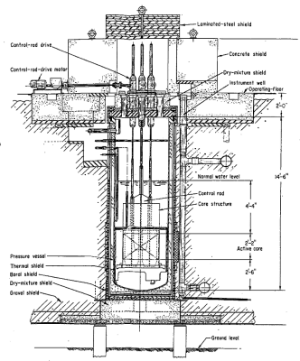

Sketch of the reactor internals (public domain).
The reactor was a conventional boiling-water reactor design that used natural circulation of light water as both coolant and moderator. The fuel was in the form of plates of a uranium-aluminum alloy.
The reactor was inside a 48-foot-tall cylinder 38.5 feet in diameter. It was made of quarter-inch plate steel. Because the thing was in the middle of nowhere in Idaho, this was deemed sufficient. There was no containment shell like you’d find on reactors nearer to population centers.
The reactor, at the time of the accident, had five control rods, although it could accommodate nine. It could also hold 59 fuel assemblies, but only 40 were in use. Because of the reduced number of fuel plates, the reactor’s center region was more active than it would have been under full operation. The rods were eight in a circle with four dummies and a ninth one in the center. Because of the missing outer rods, the center control rod was more critical than the four others.

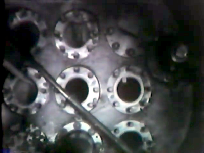

Actual photo of the destroyed reactor taken by a camera on the end of a crane.
You can place a lot of blame here. Of course, you probably shouldn’t have been able to pull the rod up that far, especially given that it was carrying more of the load than the other rods. The contractor that helped operate the facility wasn’t available around the clock due to “budget reasons.” There’s no way to know if that would have helped, of course.
But the real question is: why did they pull the rod up 20 inches instead of four? We may never know. There are, of course, theories. Improbably, people have tried to explain it as sabotage or murder-suicide due to some dispute between Byrnes and one of the other men. But that doesn’t seem to be the most likely explanation.
Apparently, the rods sometimes stuck due to misalignment, corrosion, or wear. During a ten-month period, for example, about 2.5% of the drop-and-scram tests failed because of this sticking: a total of 40 incidents. However, many of those causes only apply when the rods are automatically moved. Logbooks showed that manual movement of the rods had been done well over 500 times. There was no record of any sticking during manual operations. Several operators were asked, and none could recall any sticking. However, the rate of sticking was increasing right before the incident, just not from manual motion.
However, it is easy to imagine the 48-pound rod being stuck, pulling hard on it, and then having it give way. We’ve all done something like that, just not with such dire consequences.
