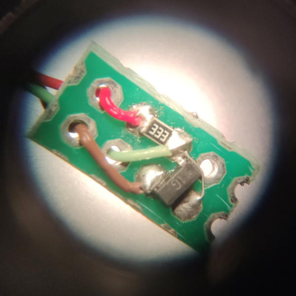

One of the joys of writing up the entries for the 2025 Component Abuse Challenge has come in finding all the different alternative uses for the humble transistor. This building block of all modern electronics does a lot more than simply performing as a switch, for as [Aleksei Tertychnyi] tells us, it can also function as a temperature sensor.
How does this work? Simple enough, the base-emitter junction of a transistor can function as a diode, and like other diodes, it shows a roughly 0.2 volt per degree voltage shift with temperature (for a silicon transistor anyway). Taking a transistor and forward biasing the junction with a 33 K resistor, he can read the resulting voltage directly with an analogue to digital converter and derive a temperature reading.

Using the -2 mV/deg C characteristic of a PN junction is really simple, but that requires calibration for each circuit to get even crude accuracy. The initial offset can be pretty bad. It’s maybe useful for a one-time lab circuit, but probably not as a real product.
More elegant is the delta-Vbe method, which measures the collector-emitter voltage at two different collector currents, and then the difference of those voltages is precisely proportional to Kelvin temperature. You can generally get 1-2 degree accuracy without calibration.
People have come up with a variety of circuits to do that, generally a bit complicated.
A good reminder that that -2 mV/K is on top of the log response of the forward voltage wrt current.
Note that this applies to a transistor, where the collector and base are shorted together, leaving just the base:emitter diode junction, so Vbe = Vce and “collector current” really means “base current”.
You can do it the simple way and measure the offset to your favorite zero temperature point (“calibrate” it), and take the -2 mV/K slope (and optionally calibrate that) to estimate the temperature. Or do as Carl says and take the measurements at two different currents and get a pretty good notion of what the offset is from the measured voltage vs. log of the current ratio.
Note you still need a calibration, to get that proportionality constant, so this doesn’t rescue you from that. It does reduce your exposure to device-to-device variability, so you might get away with doing this just once for a design rather than for each temperature sensor you install.
You already get a long way to repeatability by using a transistor instead of a diode though: Process variability is generally tighter.
By measuring at two different currents you can also eliminate the wire resistance of remote sensors. The voltage drop of wire is linear with current, not so with pn junctions.
