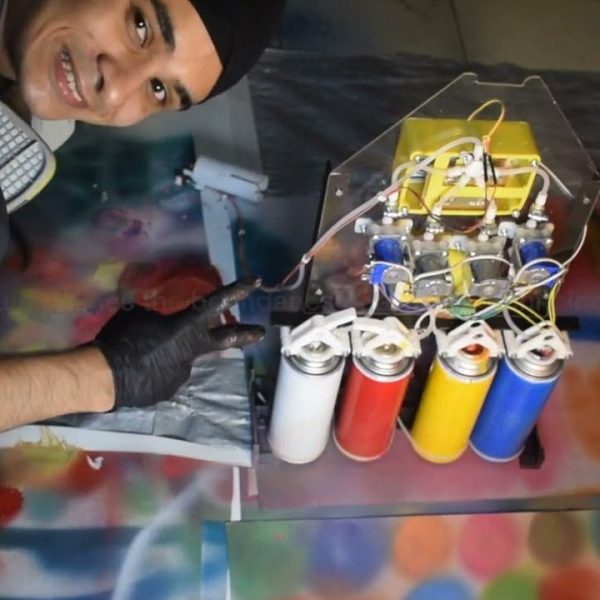

One of the problems with being a graffiti artist is that you have to carry around a different spray can for each color you intend to use. [Sandesh Manik] decided to solve this problem by building a rig that can produce a wider range of colors by mixing the paint from several cans at once. Check it out in the video below.
The project is called Spectrum. It uses four off-the-shelf spray paint cans—colored red, blue, yellow, and white—and mixes them to create a wider range of colors. All four cans are hooked up to a single output nozzle via a nest of tubing and a four-to-one tube manifold.  Key to controlling the flow of paint is a custom device which [Sandesh] calls the “rotary pinch valve,” with one fitted to the feed line coming from each spray can. These valves use a motor-driven lever to pinch a plastic tube shut, allowing them to control the paint flow. This design keeps the mechanism and paint completely separate, which was important to stop paint from fouling the valves in short order. It also prevents backflow, which keeps the paint going towards the outlet and prevents ugly messes. By quickly actuating the valve, the paint flow from each can is modulated to mix various colors as desired.
The mixing valves are under the command of an Arduino Nano. The microcontroller reads a series of knobs to select the amount of each component color to mix, and displays relevant information on a screen. Then, when a pushbutton is pressed, the valves are actuated to spit out the right amount of each paint from the atomizer nozzle. [Sandesh] went so far as to include an advanced “gradient” mode, where a force-sensitive button allows the device to transition smoothly from one color to another depending on how hard the button is pushed.
It’s a neat concept which we’d love to see explored further, perhaps with a more traditional selection of CMYK paints rather than the more unusual red, yellow, blue, and white. We’ve also seen some fun spray paint projects before, like this neat wall-mount plotter. Video after the break.

    The CMYK color model is a transparent-media (usually dye-based) subtractive process that works by subtracting colors from the reflected light in the substrate and is not well suited to opaque media, particularly if it’s on a random surface. Misunderstanding how the color system works and how it interacts with the substrate color has led to any number of hilarious failures in commercial use and would likely be a mess here as well.
    This device is effectively an RGB+W system that mixes opaque colors on the fly (rather than in overlays) and will work much better with opaque off-the-shelf spray paint, though if you were to digitally map a project from a standard RGB file you’d do better with explicit green rather than mixing blue and yellow to get there.
  5. Forgot to add that the project is working from fundamental primary colors (Red, Blue, Yellow) + white that can be combined to yield any opaque color required and wouldn’t map exactly to RGB either.

  11. That’s pretty cool. You can do some mixing by hand, but it’s very difficult. This is beautifully simple.
    I do think a hue / brightness control setup would be easier though. And I’d add a black can.
    The only other thing is you need to switch nozzles a lot when spraying; I remember having two cans of the same colour out with different nozzles. But you can probably switch nozzles on this.

    Pretty cool execution of the valving, easy hose replacement if fouled by dry paint.

  15. I wonder if this system would be better served by using systolic pumps that are driven by servo motors?
    I think it would offer much more control over the mixture, and an additional benefit would be total control over nozzle pressure. I’d imagine programming it to be automatic would be kinda tough, but maybe keep it simple and have a simple servo driver for each that is just controlled by a knob.
    With the systolic pumps they’d probably want to incorporate some sort of high pressure limit/cutoff though.

      Anyway, talk about this project. It’s fantastic! That bit where he has the trigger control the setpoint along a color-mix gradient? That’s brilliant, and enables artistic effects that are otherwise impossible.
