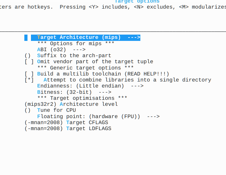

The CPU on the printer is an odd bird. As I noted last time, the executables use the r2 instruction set but also use the nan2008 convention which is usually found in r6. While Crosstool-Ng is good at letting you specify exactly what you want, it isn’t always clear on how you specify every detail.
To be fair, just like with Zig, some of that may be on me. I don’t use Crosstool-Ng or Zig every day, so maybe I was making either or both of them too hard. The bad news: It took me three or four attempts to get the right toolchain. The good news: It was a lot easier than manually downloading a bunch of stuff, trying to fix it up, building it, and still having to do it three or four times.
Configuration
Most, but not all, of the necessary changes were here.
Sort of like buysbox or building a custom kernel, the configuration for Crosstool-Ng uses the command: ct-ng menuconfig. This gives you a menu where you can set options about what you want and where you want it stored.
The problem is that the nan2008 setting I needed isn’t part of a standard mips32r2 setup. I suspect that if I had needed mips32r6, everything would have just worked. But, of course, I’m not that lucky.
In the target settings, I needed to match all the specifications, of course, but I also needed to add -mnan=2008 to both the CFLAGS and LDFLAGS as you can see in the figure.
So what’s so hard about that? Just those changes won’t produce a working toolchain for my printer. The C compiler also needed --with-nan2008 (in the C Compiler options screen under extra target CFLAGS) and the same option needed to be placed in the C Library screen, too.
Of course, it is like a word search puzzle. Once you see the answers, they look obvious. But when you are searching through pages of options, it is easy to miss one. It isn’t like there is a checkbox for “Use nan2008” that does it all for you because using nan2008 with mips32r2 is “strange.”
