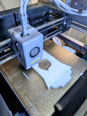

My current “main” 3D printer is a Flashforge AD5X: a nice, cheap machine that does four colors with the purge/exchange method. It sort of runs Klipper. I say sort of because Flashforge has Klipper running on a Linux host in the box, but it is massively crippled and modified. I’m sure it works for most folks. I’m also sure that if you know nothing about Linux, Klipper, or 3D printing, the experience is probably better thanks to all the cloud point-and-click interfaces. But, of course, I check none of those boxes.
I’ve had the printer for probably a year or more. Almost immediately, I put a “mod” on the printer to give it a more true Klipper interface and gave me things like shell access. There are several that I think will do this, but I used Zmod, which doesn’t totally replace the printer’s firmware; it just sort of patches it and extends it. You can easily bypass or even remove it and go back to the stock printer, although I would not want to.

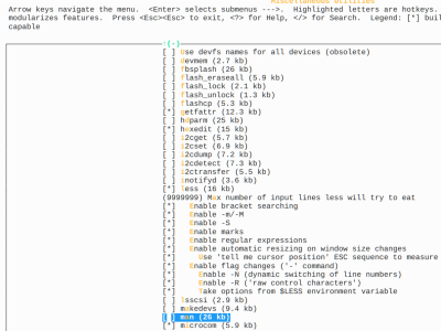

The configuration menu for busybox lets you customize it to your liking or, at least, requirements.
Configuring busybox is a matter of using a menuconfig system similar to building a kernel. I mainly asked it to make a static copy in options and then just picked a bunch of things I wanted, especially less and more.
Many programs, including less, have options to help you minimize the size. For example, you could disable regular expressions or make it not read $LESS for options. I left nearly everything on for most of the programs.
