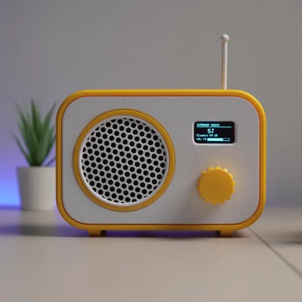

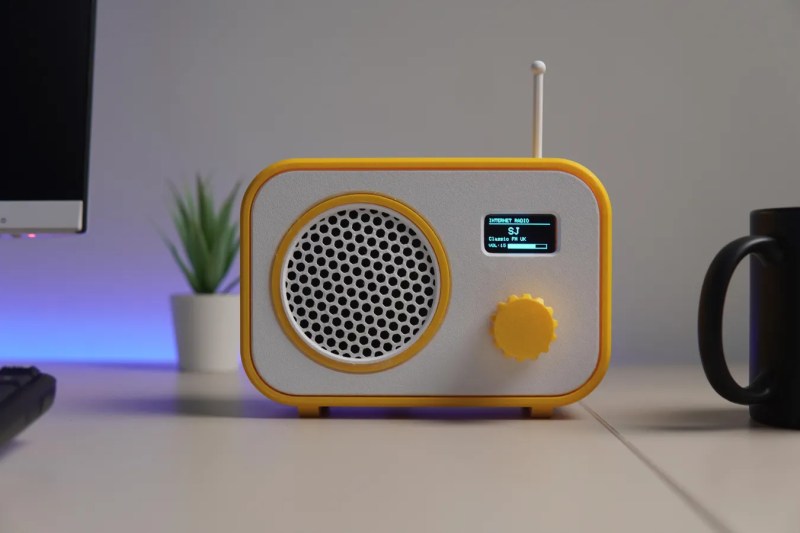

Broadcast radio isn’t as popular as it once was, its popularity suffering in turn due to technologies like MP3 players and music streaming services. If you don’t fancy either of those, you might like to listen to some internet radio stations, using a rig like the one [CodersCafeTech] built.
It’s a simple desktop radio set, but instead of tuning in to AM or FM broadcast bands, it has an antenna for 2.4 GHz instead. That’s because inside this radio is an ESP32-S3 development board, which is equipped with onboard WiFi hardware that lets it connect to the internet. It’s hooked up to a 1.3-inch OLED display over I2C, which acts as a user interface in concert with a rotary encoder. Sound is handled with a MAX98357 I2S audio amplifier, hooked up to a small 3 W speaker. Once programmed appropriately, all the unit needs is a WiFi SSID and password, and the URL for the internet radio station you’d like to listen to.

Why do even commercial products always use the tiniest possible display? With a plethora of displays to choose from, please think about useability.
What’s not useable with that screen? It’s a radio. You listen to radio. Listening isn’t done with eyes last time I checked.
Check back with us when you’e older…. age > 45, but especially > 55 or 60.
You’ll find your question has answered itself.
Yes but a bigger screen would be beneficial or even a way to enlarge the font. My eyesight is perfect but I struggle sometimes to read the info on the usually smallish screen. Listening is where it’s at bit that does involve reading some text.

Nice build although I think a larger, more useful display would have been a nice touch. Also, the plastic white “antenna” is for looks only, not even 2.4 GHz, and is not even mentioned in the text of the article.
I meant to say “text of the instructable.”
