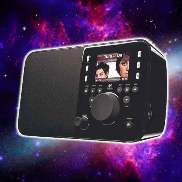

There are plenty of Wi-Fi radios out there that were built over the last two decades or so. However, many older models are now becoming less useful because many internet radio stations are switching to newer streaming formats that they don’t support. [Clifford Farrugia] has been working on a little project to save these appliances from the e-waste bin.
The HLS Radio Converter is the result of that work. It’s a small open-source tool that converts modern HTTP Live Streaming (HLS) protocol streams into regular old HTTP MP3 streams that older internet radio appliances are built to decode. You can run the tool on something as simple as an old Raspberry Pi. To make it work, you just give the tool the URL of the stream you’re looking to convert, and it then spits out a new URL to point your radio to which has the stream in the old-school format instead.

  2. Pictured is a Logitech radio. A lot of SqueezeBoxes out there, including the SB3 with it’s nice fluorescent bluish green display by Noritake. Since Logitech web support for SB was shut down, the Lyrion Music Server (often mounted on a Pi) is the way to keep these legacy players working within the home. How does this stream converter integrate with LMS? Or does it replace it, after all only a simple internet radio station list is required for selection by the legacy SB device. Thanks!
    1. The image used may be a bit misleading here. Those using LMS don’t need this as there is a plugin for LMS that does something similar to support HLS streams.
      These are for those radios that still work fine for MP3 streams but have no support for HLS. Radios based on Frontier Silicon such as those from Roberts which these days use airable.fm to manage their stream lists are such an example.
    2. The LMS already converts streams on it’s own, using ffmpeg, and acts as a proxy.
      The players announce their class when they connect to the server, so the server knows what formats they can decode, and when to transcode.
    3. Agreed, not really needed for squeezebox radios. For anyone that uses music assistant/home assistant – an improved version of the squeezelite provider is in progress now to allow full client side browse/media selection – another option if you already have these and don’t want to keep a seperate LMS server running.
