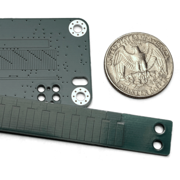

If you’ve ever pulled apart a set of digital calipers, you’ve probably marvelled at the capacitive encoder that does all the measuring work. There’s nothing stopping you from using the same techniques yourself, as [Nick] demonstrates with an open-source capacitive encoder of his own design.
The sensor PCB works by by having a grid of eight transmitting antennas, etched into a PCB, beneath a larger receiving antenna. The transmitting antennas pulse out a pattern as the sensor PCB moves, with the signals bouncing back from the reflector PCB which is fixed in place. The varying capacitance caused by the position of the reflector elements relative to the sensor PCB varies the strength of the pulses hitting the receiving antenna. A microcontroller—in this case an STM32—can read those pulses to determine the displacement of the sensor PCB relative to the reflector down to a very fine degree. In this case, to an accuracy of 40 micrometers. Not bad!
If you need ultra-fine linear tracking for something you’re building, you might find this project very useful. Files are available on Github for the curious, along with a great explainer on exactly how the capacitive coupling becomes a positional reading. You can also study previous teardowns we’ve featured on cheap digital calipers, just to round out your education further. If you’re working on your own impressive workshop equipment, or subcomponents of such things therein, don’t hesitate to let us know on the tipsline!

I wonder if having the antenna side not with straight, but zigzag lines. In the latest log they were having a systemic error with the copper free gaps on the emitter side.
I think with the zigzags there never will be a copper gap lining up and thus no/less error? (something like: https://fab.cba.mit.edu/classes/863.19/Architecture/people/Alex/Week11/index.html)

The question that bothered me: what is the speed limit? is answered in the README:
“Conservatively, the maximum speed might be 0.6m/s, although I have not tested this.”

I like this, but left wondering if there is any limit, other than PCB capability, on the length of the antenna section? Can shorter 0.5m lengths be added together in some way? I’ll ask GPT6.
Computer says Yes—roughly 0.5 m sections could be joined in principle. The difficult part is preserving the copper pattern and alignment across each joint. I found no specified maximum length, but also no documented test of a joined, metre-scale version.
Assuming by “antenna section” you mean the long stationary strip, the project calls that the reflector. It is passive; the transmitters, receiver and electronics sit on the moving readhead. The author explicitly describes extending the reflector by repeating its pattern every 5.08 mm (200 mil). Hardware documentation
That means there is no obvious electrical limit tied directly to total strip length: my engineering inference is that the readhead primarily interacts with the pattern immediately beneath it. You would not need to carry the sensing signal electrically along the entire rail.
Joining sections would need a deliberately designed joint:
– Maintain the pattern spacing across the seam. For identical modules, choose a module-to-module spacing that is a whole multiple of 5.08 mm—for example, 497.84 mm = 98 repeats. Exactly 500 mm does not meet that condition. Include any physical joint gap when calculating that spacing.
– Place the seam between complete copper features. Extra blank board margins, missing features or a large gap would disturb the measurement while the head crosses. The reflector sections should not need signal wiring between them; their patterned surfaces need to align.
– Keep the surfaces flush and straight. A common rigid backing with precise locating features would help. The nominal readhead-to-reflector gap is only 0.1 mm, so a step between boards matters. The author has not yet quantified sensitivity to gap, sideways offset or tilt. Mechanical integration
Those joint suggestions are an engineering proposal, not a tested assembly method supplied by the project.
Other practical limits remain:
– Thermal expansion and dimensional accuracy. As an illustration, Isola FR408HR specifies an in-plane expansion of 16 ppm/°C: an unconstrained 1 m length changes by 160 µm over 10°C. Your actual laminate and mounting would determine the result. That already exceeds the project’s quoted 40 µm electrical accuracy, so that figure should not be treated as a guaranteed accuracy over a long rail. Isola datasheet
– Continuous tracking. This is an incremental encoder. A sufficiently bad seam could cause a position error or lost period count, which can persist after crossing it. Operating principle
– End allowance. The sensing grid is 30.48 mm long and must remain fully covered. Usable travel is therefore patterned length minus 30.48 mm, before mounting allowances. Reflector dimensions
I would first prototype one joint using two short sections, then measure repeated crossings in both directions against an independent reference. If a sufficiently clean joint is impractical, two readheads spaced so that only one crosses a seam at a time could provide a handover—but that would require additional electronics, calibrated offsets and firmware changes.
