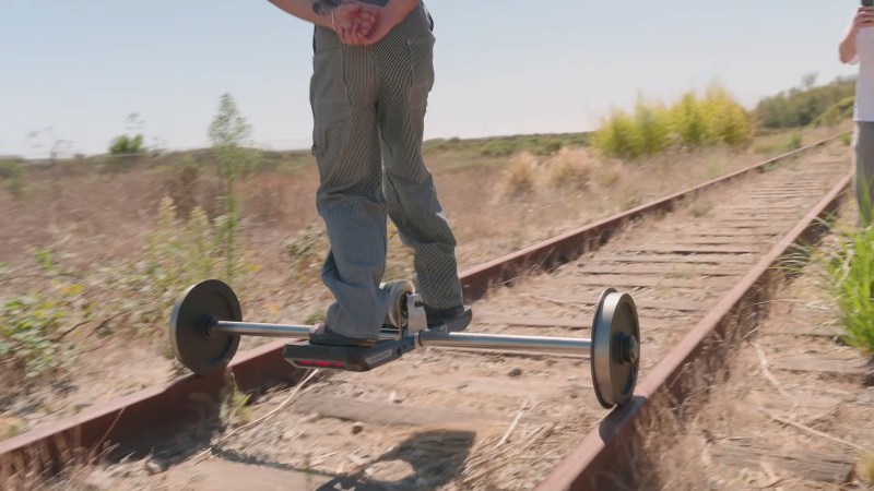

The US has tons of abandoned rail, especially in urban environments, so it seems a shame to let it go to waste. [OneWheel] decided to modify one of their boards to ride the rail behind their office.
The stock OneWheel frame was sectioned and CNC cut mounts were placed in the center to raise the motor above the deck. Steel rail wheels sourced from eBay were then attached to an axle run through where the original wheel was mounted in the center. The motor housing was turned down on a lathe for better clearance, and then a bike sprocket was attached to chain drive the train axle.
