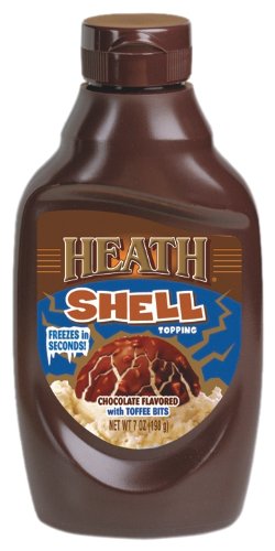

    • Hirudinea says:
      Have you considered using this stuff…
      There are also recipes for homemade versions, combined with a cooled surface (mabye put the cracker on a piece of dry ice) and you might get better results. (Mmmm, I’m drooling!)
