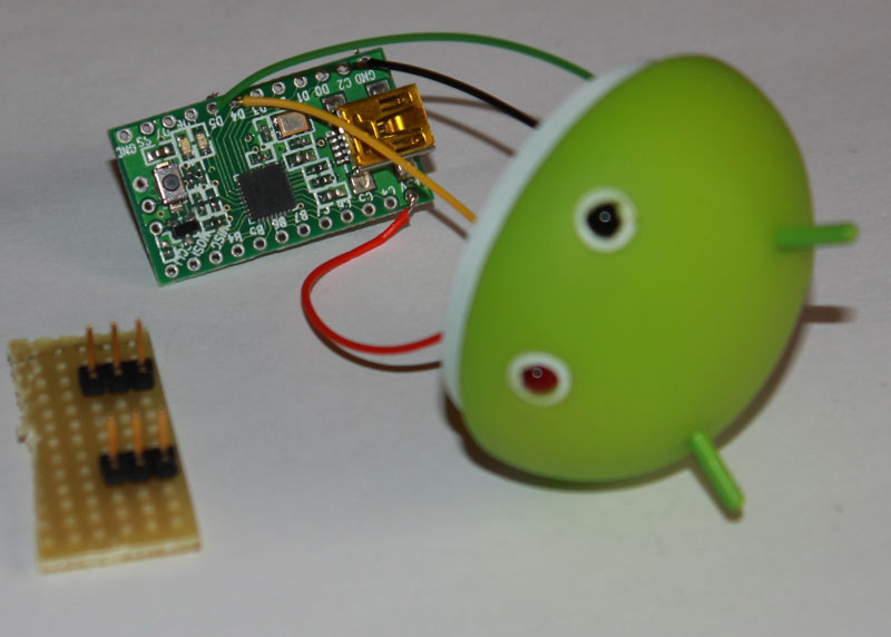

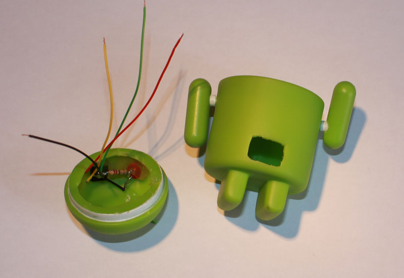

lol! yesterday I have made a similar think for VLC using an android action figure as box!
http://www.lorenzoboasso.it/uploads/irdroid/IrDroid1.jpg
http://www.lorenzoboasso.it/uploads/irdroid/IrDroid2.jpg
http://www.lorenzoboasso.it/uploads/irdroid/IrDroid3.jpg
This is the second part of a bigger project I’m working on. I just thought this would be a good addition.
