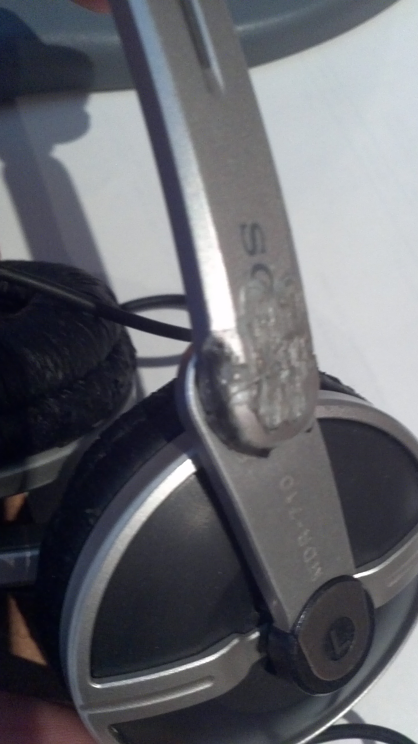

I too use stainless safety wire in this manner.. heat a small bit with the torch with a slip knot embed it in the plastic and then heat up a bit more wrap it in to the plastic and continue to do so down the object then clip off the remainder when i’m done and it only leaves a tiny nub that can be sanded down a bit.
I have found that melting staples into the plastic across the fracture (after glueing) to be quite effective. The the ability to loop and angle the end of the staple helps anchor the staple so it can take part of the tensile stress (yes it might be weak but it’s better than broken). Example (has in fact cracked again but the staples still hold it together):
http://www.jakebyrne.com/open_media/reinforce_joint_with_staples.jpg
I have had success with a number of headphones that are used regularly.
Might be able to combine this option with the acetone idea mentioned above…
I think this 6-months later piece of genius may actually save my headphones. I’ve been grumbling about getting a new pair for ages, just cos the plastic band’s snapped by the earpiece. Sure I’ve got some acetone somewhere.
