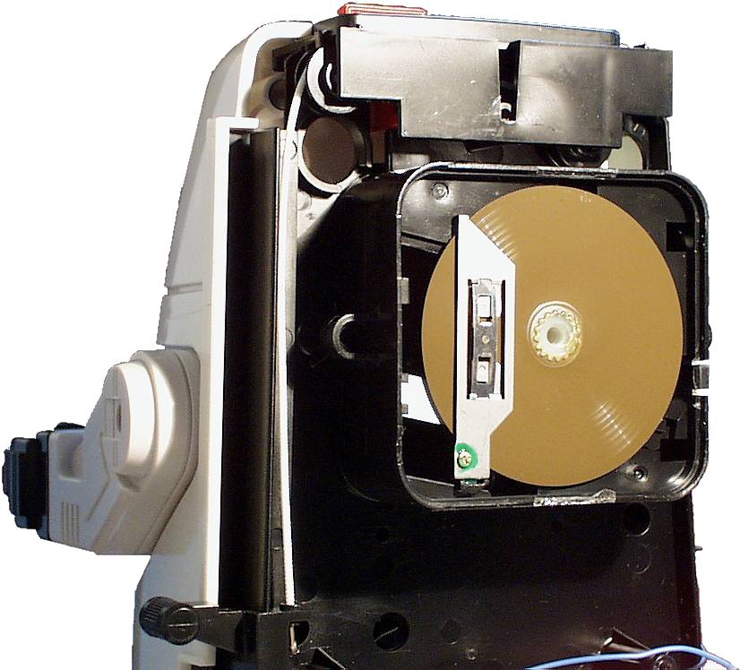

  4. A long time ago I bought a 1985 Tomy Chatbot from a car boot sale and had to do a little maintainance to get it all working properly, namely the mechanism that allows you to record and playback a short piece of audio.
    The front of the robot has two eyes which make it look like there’s a small cassette tape in there, but taking the back off I was surprised to see that it uses a rudimentary record & playback mechanism which uses a magnetic disc:
    http://www.haku.co.uk/pics/ChatbotInsides1.jpg
