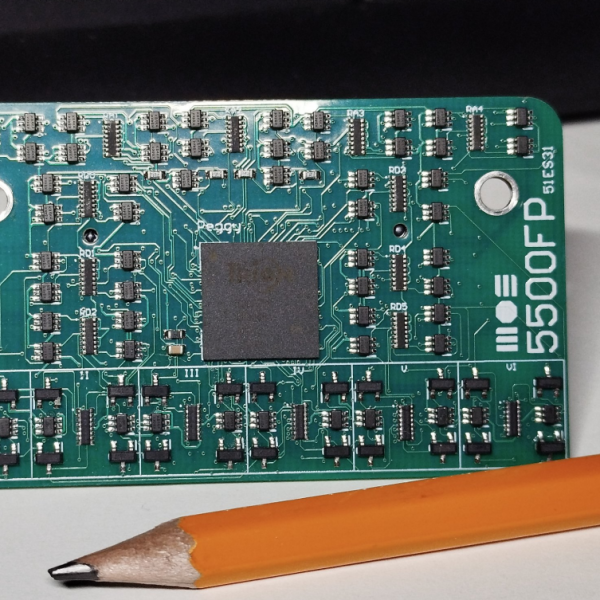

The device in question is called the 5500FP, as outlined in a research paper from [Claudio Lorenzo La Rosa.] Very few ternary processors exist, and little effort has ever been made to fabricate such a device in real silicon. However, [Claudio] explains that it’s entirely possible to implement a ternary logic processor based on RISC principles by using modern FPGA hardware. The impetus to do so is because of the perceived benefits of ternary computing—notably, that with three states, each “trit” can store more information than regular old binary “bits.” Beyond that, the use of a “balanced ternary” system, based on logical values of -1, 0 , and 1, allows storing both negative and positive numbers without a wasted sign bit, and allows numbers to be negated trivially simply by inverting all trits together.
The research paper does a good job of outlining the basis of this method of computing, as well as the mode of operation of the 5500FP processor. For now, it’s a 24-trit device operating at a frequency of 20MHz, but the hope is that in future it would be possible to move to custom silicon to improve performance and capability. The hope is that further development of ternary computing hardware could lead to parts capable of higher information density and lower power consumption, both highly useful in this day and age where improvements to conventional processor designs are ever hard to find.

  2. It’s worth pointing out that this device is simulating ternary logic with binary logic — FPGA hardware signals can be either on or off, and don’t support the three-state signalling required for true ternary logic, meaning that each trit is represented as two bits. These are then converted via analogue circuitry into balanced ternary for the external bus interface.
    It looks like the CPU is written in VHDL, which makes me wonder whether there’s any reasonable code path from the VHDL design to real ternary silicon — I suspect not, meaning they’ll have to reimplement it from scratch with custom ternary tooling. (Which in turn makes me wonder why they chose to do the CPU prototype on an FPGA rather than just emulating it with a cheap ARM or something.)

      Internally the FPGA is binary, but if you read the paper, the external world is balanced ternary (-V/0/+V). That’s why it’s as slow as it is – the external interface conversion (balanced ternary to 2 bits) is slow. In other words, the FPGA is capable of interacting with actual external silicon operating in balanced ternary.
      1. “No matter what they’re going to need a custom VHDL->ASIC synthesis engine anyway, so if, for instance, you go ahead and use VHDL typing to just pass trits around and then at the necessary level you decode the trit into a binary pair and operate as needed, you just swap out everything past that point with your custom library.”
        Yes, that’s exactly how it is. But they already exist and some are also freely usable and downloadable. Try searching for “Triton TPU” on GitHUB.
        “That’s why it’s as slow as it is – the external interface conversion (balanced ternary to 2 bits) is slow”
        It’s not actually the conversion itself (which is almost instantaneous), but the fact that the external discrete components, in this implementation, don’t support more than 20/25 MHz.
