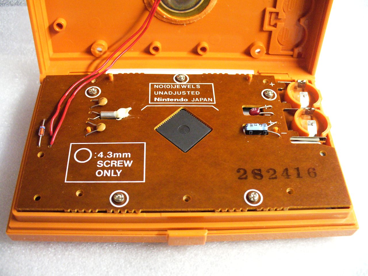

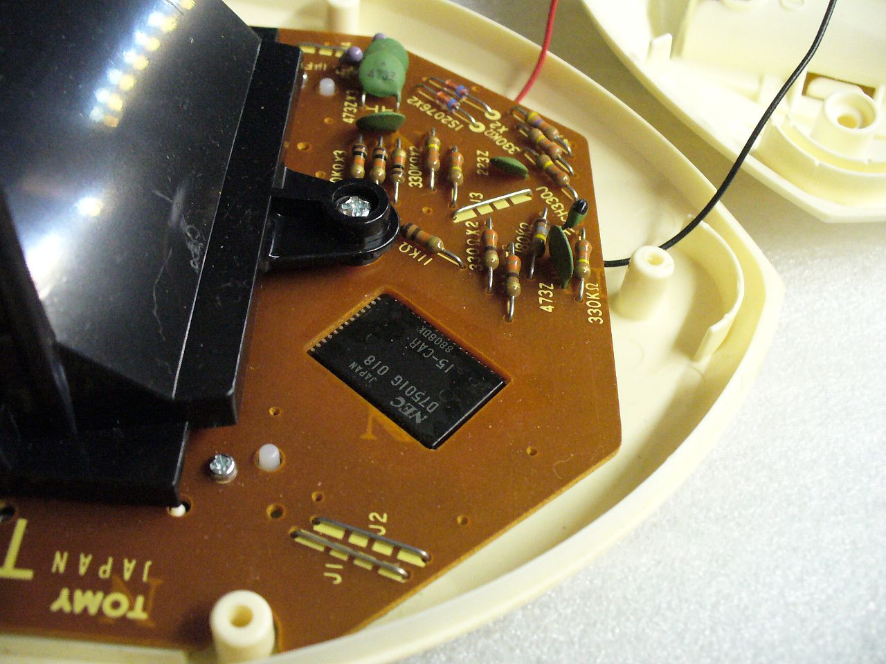

  2. It’s a tried and tested method of making circuitboards thinner through milling out space for the packaging of SMD components, the plethora of Nintendo Game & Watches dating back to the beginning of the 80s and the Tomytronic 3D handhelds in the early 80s use this technique for housing their main IC on the circuitboard. I’m sure there are many more other early handhelds which use this method.
    But the thinness of this device is most impressive.
    1. I was planning to use the exact same technic for my electronic business card. But there is one problem with this kind of component placement : you can’t route under them. And routing under components can sometimes be a lifesaving operation.
    2. Haku! I love your comment! I thought I remembered seeing this kind of cutout placement for the MCU but was unable to find images online. I liked to take electronics apart as a kid so perhaps this is where I first saw one. Please let me know if you can find an example and share it!
