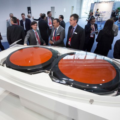

Of special interest in the new 2Ku system is the antennas strapped to the top of a GoGo-equipped plane’s fuselage. These antennas form a mechanically-phased-array that are more efficient than previous antennas and can provide more bandwidth for frequent fliers demanding better and faster Internet.
The Antenna Pod
The Antenna Pod

  3. I’d love some more information about those antenna’s, how they work and such! I’ve never seen a circle shaped radiator like that.
    1. The red part may be a cover or radome type of widget, underneath it probably looks like the typical octagon shape of a commerical aircraft wx radar. And probably works in the same way if it is mechanical, which would mean it is partially steered via actuators and partially electronically scanned via phasing. Two giant patch antennas would make a weird phased array if that’s what these are???
      Anyway, the shape of the antenna can have a few effects, radiation pattern being the main one, but round isn’t out of the ordinary for sure
  4. Um, mechanically-phased-array?
    I don’t think that’s right…. It could be that these are mechanically steered phased array antennas. Meaning they can only be electronically steered (phase steering) in one axis, or are limited in steering angle and need extra help “getting” there. Or Phased in one axis and mechanically steered in the other? I would find it difficult to believe they are using mechanical phase shifters in such a later system as this. Media misunderstanding of the technology perhaps ?
    1. Yeah, I don’t think these are phased array antennas at all after a little more digging. They are simply a bi-static pair of patch antennas, one for uplink and one for down link, and if they are “steered”, it’s via mechanical actuators. Circular polarized hence the shape, which would make sense in this application. Nothing exciting here aside from fast in-flight internet.
    2. “mechanically steered phased array” does make sense. AFIK most of the old phased array radars used mechanical phase modulators to steer the beam. I think only quite recently have phased array antennas started to switch to a transceiver per element. (FPGA’s are getting cheap enough, and electronic steering is more versatile)
    3. This is probably an antenna by Thinkom, and is actually a phased array.
      http://thinkom.net/wp-content/uploads/2013/11/TK-TSAT300-Final-Data-Sheet.pdf
      I don’t recall exactly how it works but basically there is a set of rotating plates with elements that adjust the phase so that by rotating them you get elevation change, and then rotating together you get azimuth pointing. Cool stuff originally developed at Raytheon from what I understand and and then spun off into this other small company.
