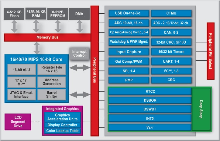

  5. That’s a very sweet piece of work but nobody should be surprised at the PICs ability to handle this. At 70 MIPS (16-bit) It is a veritable super-computer compared to the 0.8 MIPS (8-bit) 1.79Mhz 6502B used in the Atari 800. On top of that the PIC has 512KB of program memory and 48KB of RAM compared to the Atari’s 16KB. The PIC24EP512GU814 is comparable to an Intel DX4 (486) circa 1994.

  7. The PIC24 is pretty high-powered so this should surprise nobody, and only supporting square waves for its audio is fucking abysmal given what people have been able to pull off on the 8-bit AVR series of chips. At the same time, the graphics are much better than I would have expected for something entirely CPU-driven without a dedicated GPU, so I think there are both positives and negatives to the project.
        1. From the PIC24FJxxxDAxxx datasheet: “The module also provides an accelerated rendering of […] rectangles, copying of rectangular area between different locations on the screen, drawing texts and decompressing packed data.”
          “Drawing texts” seems to be code for “bitplane transformations”
          Maybe misusing the LCD parallel interface to drive VGA would be an interesting use case.
