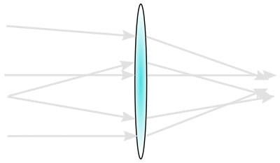

To get into the nuts and bolts, we’ll need to take a look at some laser optics. First off, keep in mind that our laser is both collimated and of a single wavelength. A high power white-light source is neither of these, but let’s look at one variable at a time.
If we were to shoot a collimated (parallel) white light source through our lens, we still can’t achieve the same power density of a laser, which consists of a single wavelength, and here’s why. In the real world, no optical lenses are perfect, and the consequence of passing white light through an imperfect lens is that individual colors have slightly different focal distances. Laser light, on the other hand, consists of only a single wavelength, which means it wont experience this spectrum splitting issue that white light experiences.
The white light’s blue components focus more closely than it’s red components. The net result? Since we can’t focus all of the input light on a single point, we reduce our overall power-density.
Let’s examine the next case: uncollimated white light. Here, we get a similar result as in the first example. Collimated light refers to the fact that the majority of our photons are parallel with each other. Uncollimated white light, like that of a lamp, features light rays that travel in all directions. For the uncollimated light that enters the lens, the angle of incidence determines where it’s actual focal point will be. In other words, each light ray with a different entering angle will have a different distance from the exit of the lens before it reaches the center where the ideal focal point would be.
Laser light can be easily collimated, which means the light rays are traveling parallel to each other. Because this is the case, each ray that enters the lens will exit and converge at the same distance, i.e, the lens focal point.
Hence laser light, being both monochromatic and collimated gives it a higher energy density than it’s vanilla white-light contender.

“In the real world, no optical lenses are perfect, and the consequence of passing white light through an imperfect lens is that individual colors have slightly different focal distances.”
No, this is an effect know as dispersion. Different wavelengths experience different refraction indexes. That’s for example why a prism breaks apart white light into a rainbow pattern.
Yeah was thinking this too.
Yea, this should be corrected. The imperfect lens comment is completely off the mark. There are few other issues with the article as well.
Yup, my thoughts as well. So-called ‘achromatic’ lenses (achromats) are not single-piece elements, rather they’re multiple lenses of different materials (differing refractive indices) bonded together. A great easy-read book is “Spectrum of Belief: Joseph Von Fraunhofer and the Craft of Precision Optics”
I interpreted his “imperfect” point to reflect properties of the real world, rather than how lenses work in theory.
Yes, but it’s not the fundamental reason why that effect occurs.
