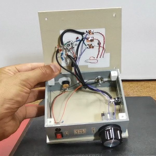

Software Defined Radio (SDR) is the big thing these days, and why not? A single computer can get rid of a room full of boat anchors, and give you better signal discrimination than all but the best kit. Any SDR project needs an RF receiver, and in this project [mircemk] used a single 6J1 vaccum tube to produce an SSB SDR that combines the best of old and new.
Single-tube radios are a classic hack, and where a lot of hams got started back in the day, but there is a reason more complicated circuits tend to be used. On the other hand, if you can throw a PC worth of signal processing at the output, it looks like you can get a very sensitive and selective single-sideband (SSB) receiver.
The 6J1 tube is convenient, since it can run on only 6 V (or down to 3.7 as [mircemk] demonstrates). Here it is used as a mixer, with the oscillator signal injected via the screen grid. Aside from that, the simple circuit consists of a receiving coil, a few resistors and a variable capacitor. How well does it work? Quite well, when paired with a PC; you can judge for yourself in the video embedded below.

  2. Is this just a tube type mixer placed ahead of Alberto I2PHD’s SDR software? In that case it is kind of wrong to call the mixer an “SDR radio.” Especially when the tube-type mixer uses an external (digital) VFO and there are not even quadrature signals (I and Q) from the mixer. Also, it is not clear that the tube-type mixer is doing much of anything — the tuning control seems to just peak the VFO input signal (not the RF coming in from the antenna!). And why does he peak the noise with the antenna disconnected? When he does connect the antenna, we see no increase in noise. That ususally indicates that internal noise generated by the receive system itself is stronger than the external “band noise.” That is not good. Bill N2CQR

  3. So, Joshua is saying that the single tube mixer is a direct conversion receiver? I still don’t really see this. You can used phasing type direct conversion receivers (two of them) fed with VFO signals in quadrature to produce I and Q signals that you could send into sound cards in the computer for digital signal processing. That is how they did a lot of the early SDR receivers. That I and Q stuff allowed them to select USB or LSB etc. I don’t see that happening here. There is no quadrature inputting of the VFO, no I and Q out. Nope. If we look at more modern SDR rigs, why on earth would you even NEED the tube type mixer? Just send the RF into an analog-to-digital converter, then to an FPGA to do the DSP. Again, we don’t see that here. And finally, as Joshua points out, the tube would need at least 35 V on the anode. Oops indeed. Is this really the kind of thing that HAD wants to promote? Bill N2CQR

  4. Why would you lower RF bandwidth by adding that huge capacitor C5? 4n7+10k is terrible.

    1. Um, it’s a RC or CRC band-pass filter (C4+R1+C5)?
      The 12 KHz intermediate frequency (IF) is wanted by the SDR software, I think.
      In pratice, it also worked with as low as 7 KHz, though.
      The 1K resistor (R3) is used to make the tube working with 6v.
      The usual working point setting is done by C6+R2, I think.
