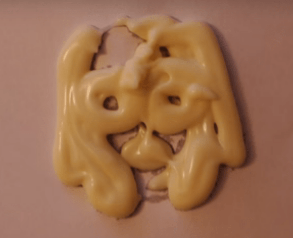

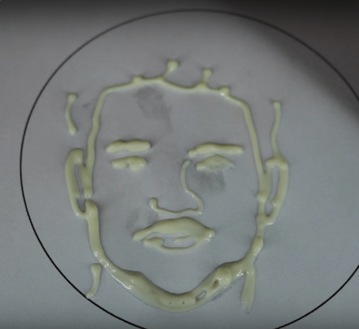

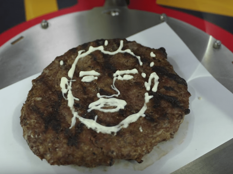

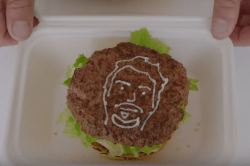

The client comes up to them and says, how can we make mayonnaise cool? So Navid’s job was to come up with a bunch of novel ways to make summer grillouts more fun. They started by mashing up a bunch of trends, and came up with “Burger Selfies” — a 3D printer that could take your picture and draw your face on a burger.
If you’ve never printed mayonnaise selfies before, you haven’t encountered half of the difficulties that Navid has. The issues started with getting a good outline of a person’s face suitable for mayonnaise portraiture. You know how you spend all your time levelling your 3D printer’s bed, and getting the first-layer Z-axis height just right? Navid was doing this with hamburger patties. They were aiming for a fully-automatic app-based solution. They ended up with a semi-automatic system where a skilled operator could make some tweaks along the way.
Needless to say, you can’t just go out and buy a mayonnaise extruder head. So Navid had to hack his own up (in a weeks’ time!). It turns out that mayonnaise is a non-Newtonian fluid, getting more viscous the harder you try to shove it through a tiny nozzle. Lesson learned, and a wider paste output solved the problem.
They chose a delta-bot because it features the client’s mayonnaise bottle dead center. It is an advertisement, after all. Much tweaking and learning to work with the material ensued. In order to get consistent prints, Navid cooked up ten burgers per day and re-used the flattest among them for his printing surface — washing it in the bathroom sink and then re-greasing it between attempts. (And you think it’s bad to have to wipe down your bed with acetone every now and then.)
With each iteration, the faces got more and more face-like. The bot was installed in a food truck, and they filmed it. All this work for a 30-second spot. But it looked great.
