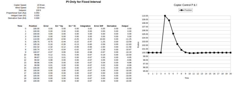

Integral Control
You bring the copter back to 100 feet despite the wind blowing. Now the controls are no longer in a neutral position, but require some input to hold the distance at 100 feet. Bringing the copter back to the setpoint and holding it there requires the integral part of PID.
The integral looks at the history of the errors over time by maintaining a summation of the error. The integral equations require a variable, the summation (Si), which is the sum of the previous errors each multiplied by Ki. The proportional component is calculated as above and added to the integral component.
\begin{aligned}  S_i &= S_i + (K_i * e) \\  C &= K_p * e + S_i \\  \end{aligned}
An alternate form, more typically shown in discussions, maintains a summation of the errors and multiplies the summation by Kp. This form leads to a problem, called a bump, if the value of Kp is changed while the PID is operating. This probably won’t happen in our systems but is an issue for long running processes like in a refinery.
Again, the chart shows the copter’s movement away from the setpoint and the recovery. Notice that the copter is stabilized in 9 seconds using PI whereas it required around 12 seconds using only P. The integral tends to get you back to the setpoint more quickly.

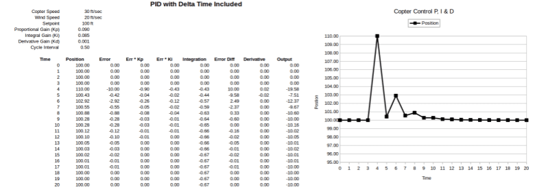

Cycle Time
The next logical step is to show you a full PID but there is another factor to consider, the time between processing cycles. I left this out above for clarity. The equations above will work okay if the PID is processed at regular intervals, perhaps being driven by an interrupt. But if the interval is not constant an adjustment must be made to the integral and derivative calculations. This requires the use of the time elapsed between each PID calculation. This is the delta time (dt). After adding the dt factor, a minimal change, the PID control value is just the sum of the previous calculations:
\begin{aligned}  e &= SP - DV \\  S_i &= S_i + (K_i * e * dt) \\  C &= (K_p * e) + S_i + K_d * (e_p - e) / dt \\  e_p &= e \\  \end{aligned}
The integral is now multiplied by dt. As a result, the summation is now the error over a period of time. If the time in error is long the integral becomes larger to more quickly force the copter back to the setpoint. If the time is small only a small correction is added.
Similarly, the derivative is divided by dt to amplify the control value.
The chart shows the full PID handling the copter deflection and return. Since the integral term is being used the copter returns to the setpoint and is stable at about 9 seconds. But it is reasonably close to the setpoint at 7 seconds, which is better than with the earlier approaches.
The dt I used is 0.5 seconds but when it was put into the chart the copter only moved to 105 feet. I doubled the speeds of the wind and copter so the movement was 110 feet to make it easier to compare all the charts.
