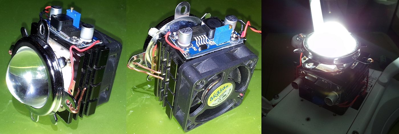

    1. 50 watt LED, nice! That’s like 20,000 times better than what I did. How hot does it get? Don’t want to find a melted quad!
        1. That looks f-ing amazing! Little heavy but now you can fly safely at night at a sand-pit for example.
    2. Personally I’d drop the 50w LED and fit a small video transmitter and camera. If you don’t fly FPV the tiny CMOS cameras will be enough… Then when you lose the model you can see what it landed in/use a directional antenna to find it.

        The 50 watt LED goes in place of it. All for a bit of fun night flying, I won’t go very far away with that LED on.
