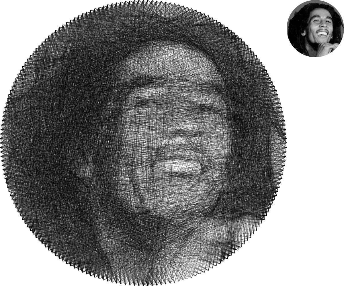

    1. I gave it a quick try calculating the string’s scores by accumulating the pixel values. The simulated result is not close to what he achieved. Seems there is quite some clever tuning required. If you’re still interested, I can publish my code (C++ and OpenCV).
      1. It is more closely related than you think, if you actually understand what you are looking at. With the string there are extra constraints but the process of discovering the correct geometry sequence is the dame idea. Unfortunately the source code for JNetic does not seem to be on that site so modifying it to add the required constraints is not possible therefore you would need to start from scratch and write a tool to do it for you.
    1. Hello Michel. Not bad at all! Missing little details still…(I think). What do you use for that? GITHUB propose by Christian above? If not, could you share please? :)
      1. Process, simplified:
        1. create a small reference image (for example 200×200 pix, a bigger one will not produce better results)
        2. create a stack of all possible lines between the pins (in my example I don’t want lines between pins that are less than 30 pins apart)
        3. pick a random starting point
        4. try all line options from this point according to the stack, calculate which option has the lowest total pixel error compared to the reference image
        5. draw the line, and remove from stack (both ways, because I don’t want the same line used twice)
        6. repeat 3000 – 5000 times

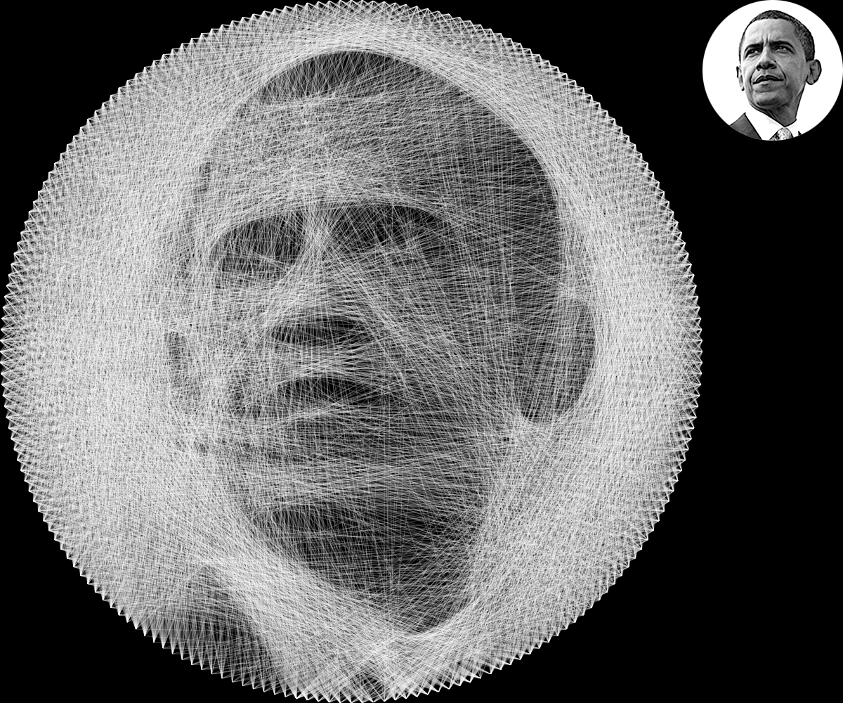

    1. For the images above I implemented a couple of subalgorithms, for example to guarantee even line distribution, additional focus maps for accurate representation of crucial details, etc.
      I think the optimal number of pins is dictated mostly by the desired resolution and the line width.
      These 2 factors together determine the maximum achievable black coverage.
      A “perfect” picture is impossible because lines have to cross lighter area’s to cover darker area’s.
      Obviously, images with darker colors at the edges are more suitable, but you could also use white lines on a dark canvas to create a picture with a light background:
      http://www.inforaction.nl/knit/obama.png

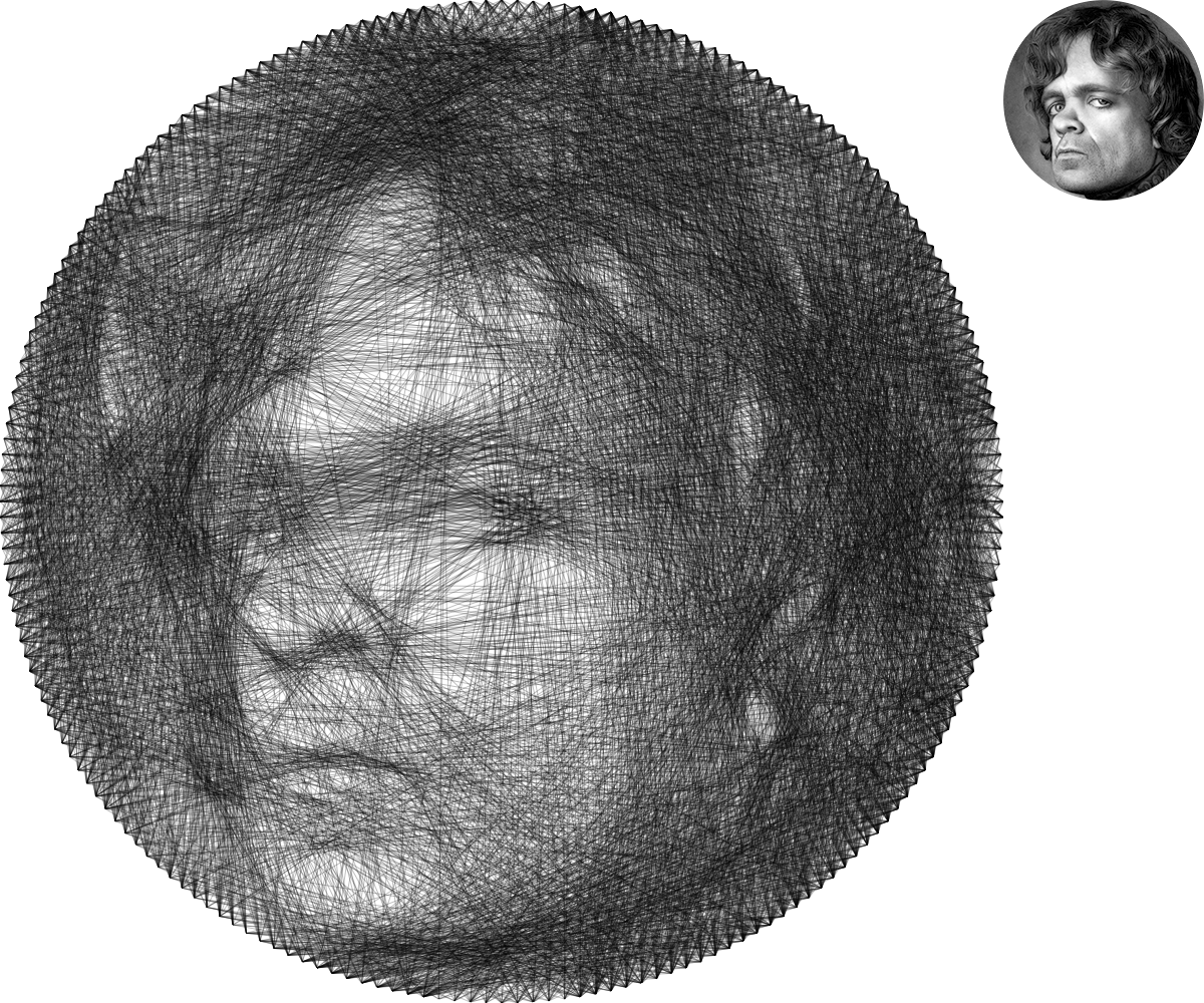

        I also noticed that when I run your animated Tyrion Lannister link multiple times and compare the resulting images, each “knit” varies slightly.
        Is this a variation that you purposely built into the algorithm?
        I am a complete new to programming but am very interested in where to begin learning how to do this.
        1. The variation is not in the algorithm, but in the function that displays the results.
          The algorithm is not included, but the pin sequence is in the config.lineSequence array in the display.js source:

          I wanted to simulate thread in real life, which will not be perfectly straight between the pins.
          Overlapping identical patterns (in this case the lines from each pin to the other pins) tend to produce secundary patterns (moiré).
          These secundary patterns are cancelled out by random variation of the line curves.
          So most lines are not perfectly straight, but have an almost imperceptible quadratic curve of which the maximum center offset can be set by the linevariation variable in the url.
          If you set linevariation=0, the result will be exacly the same each time, but you will see moiré patterns:
          http://www.inforaction.nl/knit/?linedelay=0&linesmax=4000&linewidth=.25&linevariation=0

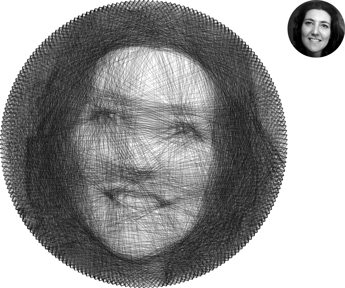

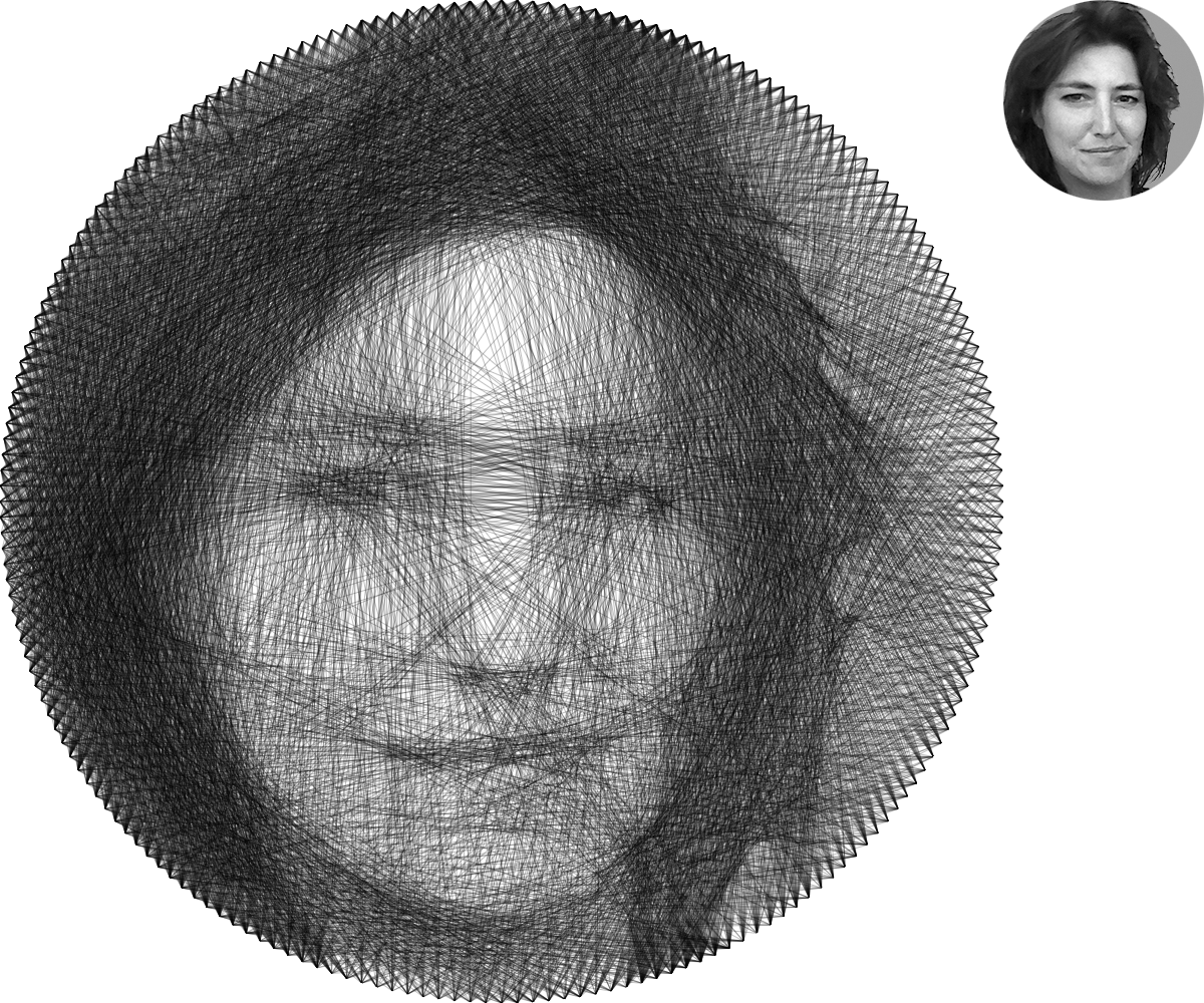

            2 extra examples:
            http://www.inforaction.nl/knit/muriel1.png
            http://www.inforaction.nl/knit/muriel2.png

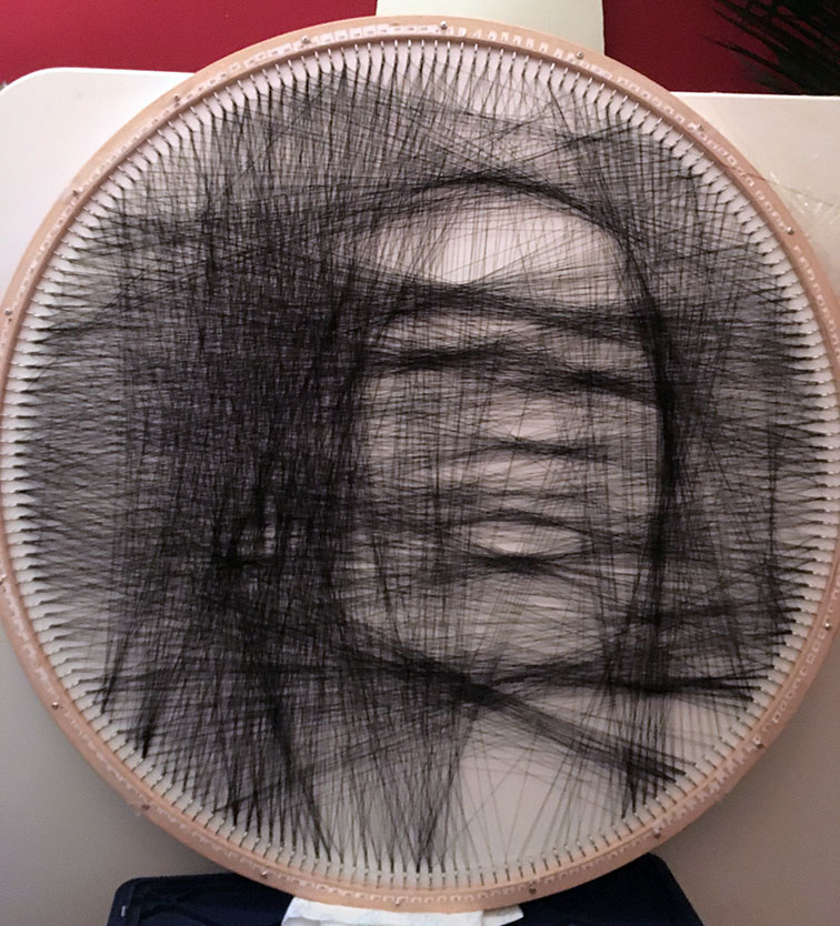

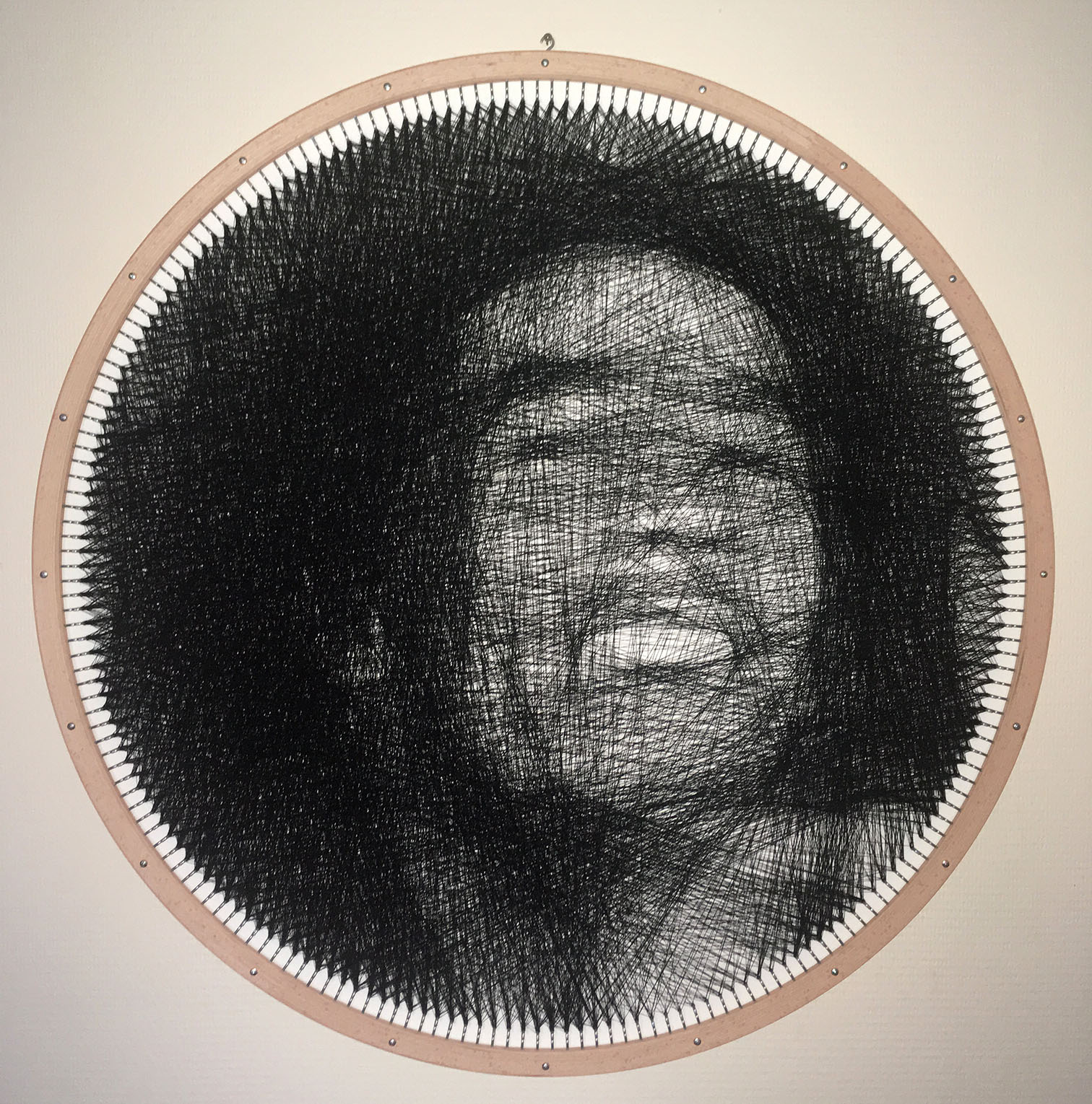

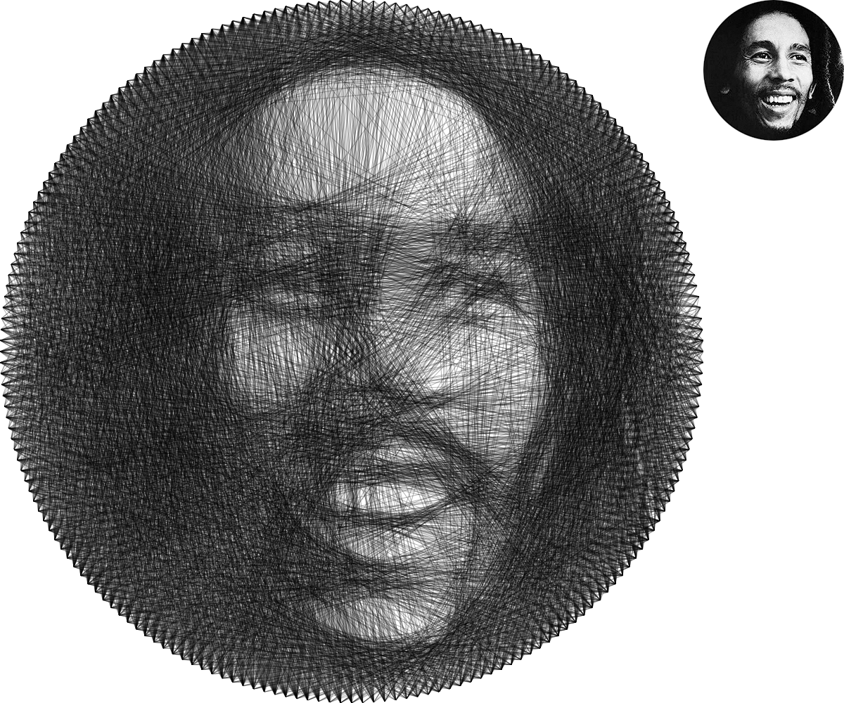

  11. An update:
    Last week I finally had time to build something.
    My girlfriend is a huge Marley fan, so I made her a knit for her birthday.
    She was over the moon with it :)
    http://www.inforaction.nl/knit/results/design.png

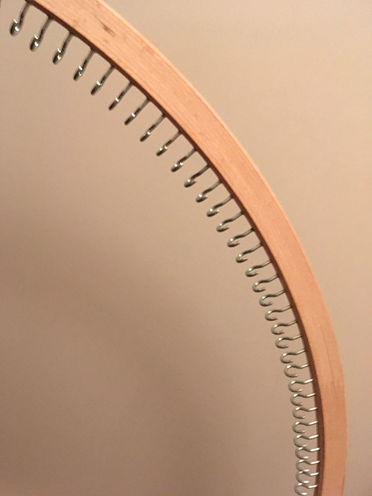

    Preparation:
    For the loom I used a 80 cm laminated wooden hoop with tiny screw hooks (20 x 12 mm).
    Using a large paper template with radians, the 200 pin locations were marked at the inside of the hoop.
    The hooks were screwed in after predrilling 1.6 mm holes with a dremel.
    Because there’s a lot of tension involved, reinforcement is needed for the woorden hoop.
    So I made a back board out of 12 mm MDF with the same diameter as the hoop.
    After painting it white, I screwed the hoop on top of it.
    http://www.inforaction.nl/knit/results/hoop.jpg

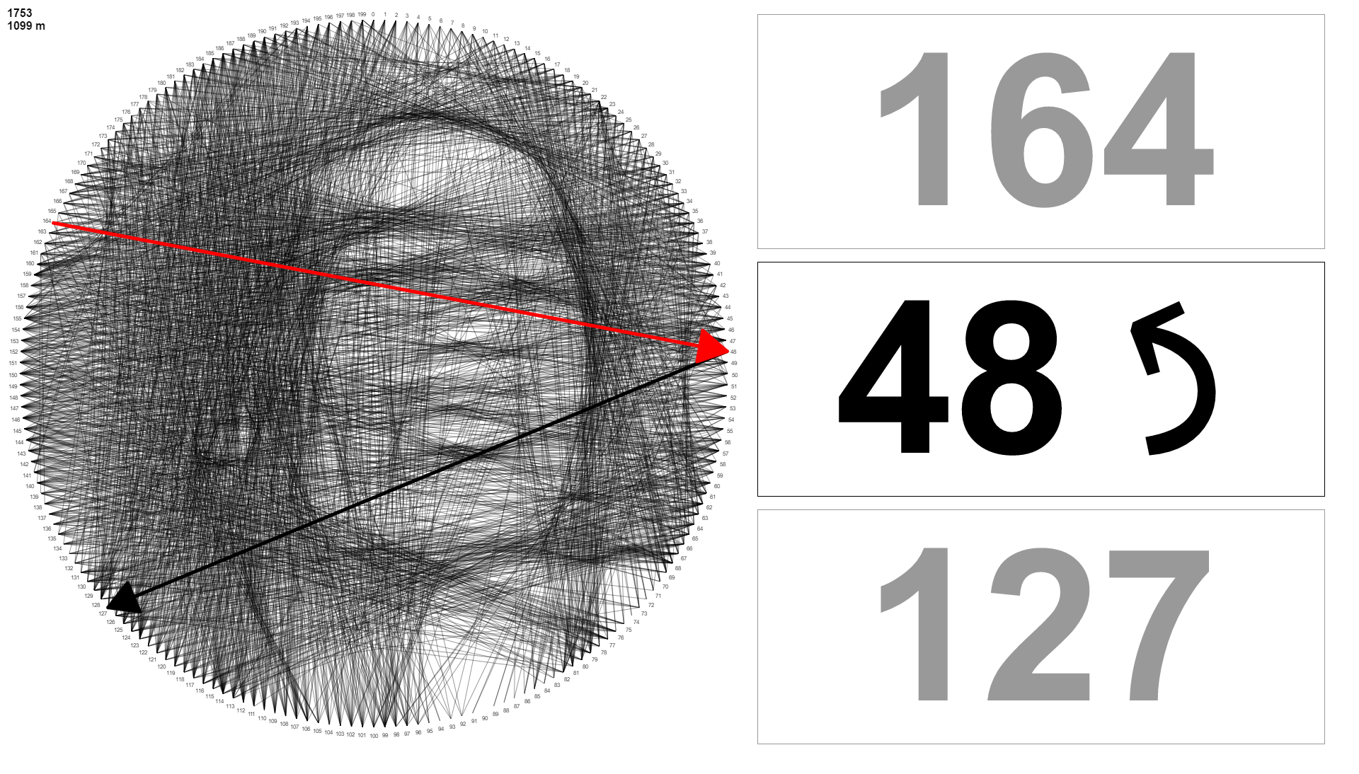

    To visualize the instructions I made an app, which also calculates the cross wire direction around the pins for consistency.
    I plugged in Google translate for spoken word instructions to speed up the process :)
    http://www.inforaction.nl/knit/results/instructions.png

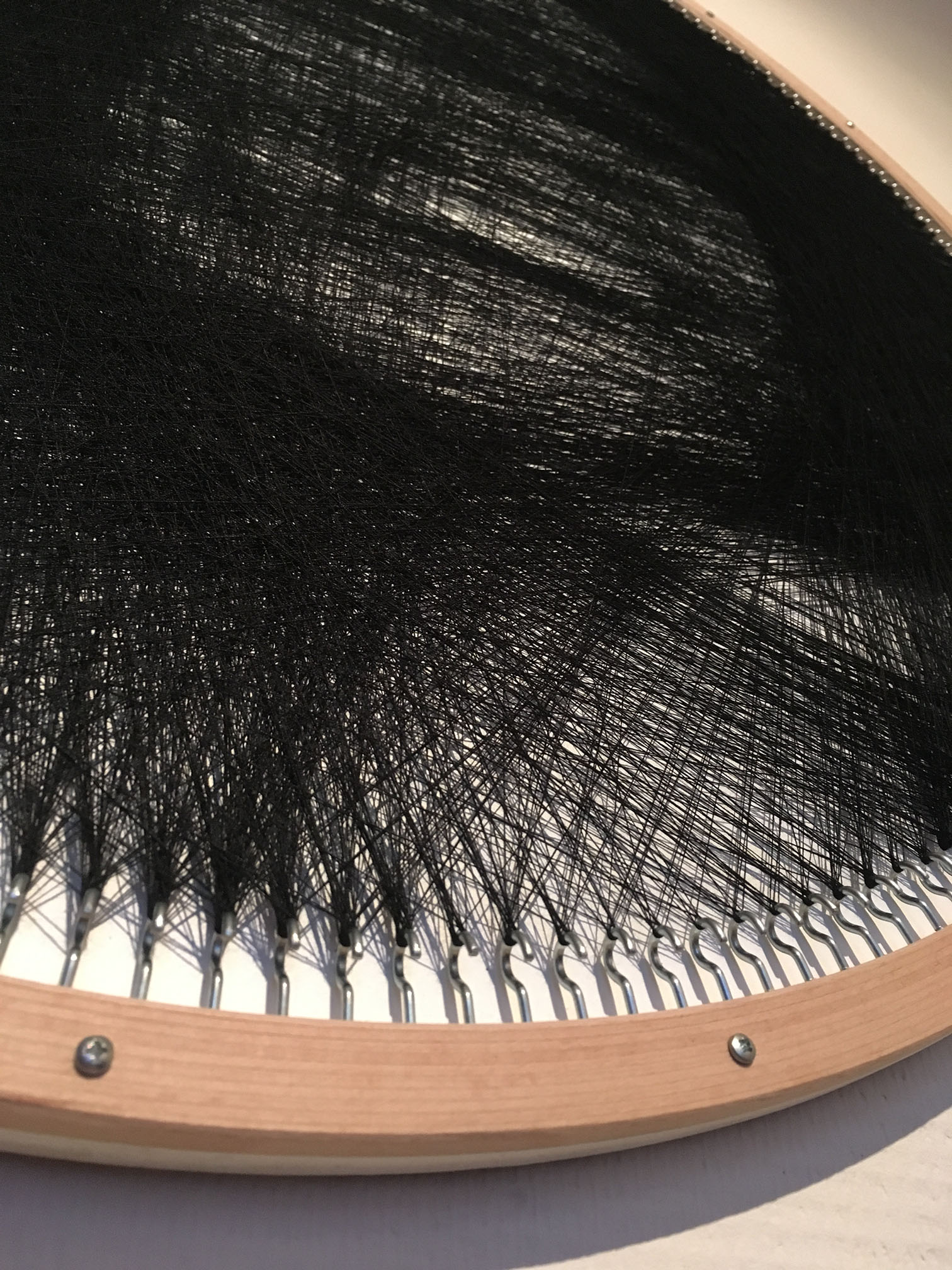

    Results:
    The final piece turned out pretty well.
    Nice picture details, and the depth effect of the stacked threads is awesome!
    The thread turned out to be a fraction thicker than anticipated by the specifications, so maybe next time I’ll use even thinner thread.
    In total I manually processed 3844 lines.
    The piece contains about 2.3 km of continuous thread :)
    http://www.inforaction.nl/knit/results/result.jpg
    http://www.inforaction.nl/knit/results/detail.jpg
    A small video about the depth effect:
    http://www.inforaction.nl/knit/results/result.mp4

    1. don’t open the image.jpg with processing. put it in the same folder as knitter.pde, and then open knitter.pde with processing.
        1. I don’t understand your question. It always picks the best next pin. Just follow the pin order printed to the processing console, e.g.:
          String #1 -> next pin: 169
          String #2 -> next pin: 122
          String #3 -> next pin: 170
          String #4 -> next pin: 124
          1. I mean.. after I run the sketch, it directly states string #2500. I can’t see t at the console “string #1”. how do I fix that? sorry again, I really want to do this
          2. Aah, I see. Please check the latest version of the sketch. I made some changes, so it saves the instructions to a text file, and additionally generates an interactive HTML page, which makes the whole process even easier ;-)
          3. Have a look at lines 9 and 12 in the code ;-)
            (The diameter of the circle is only used to calculate the total thread length)
