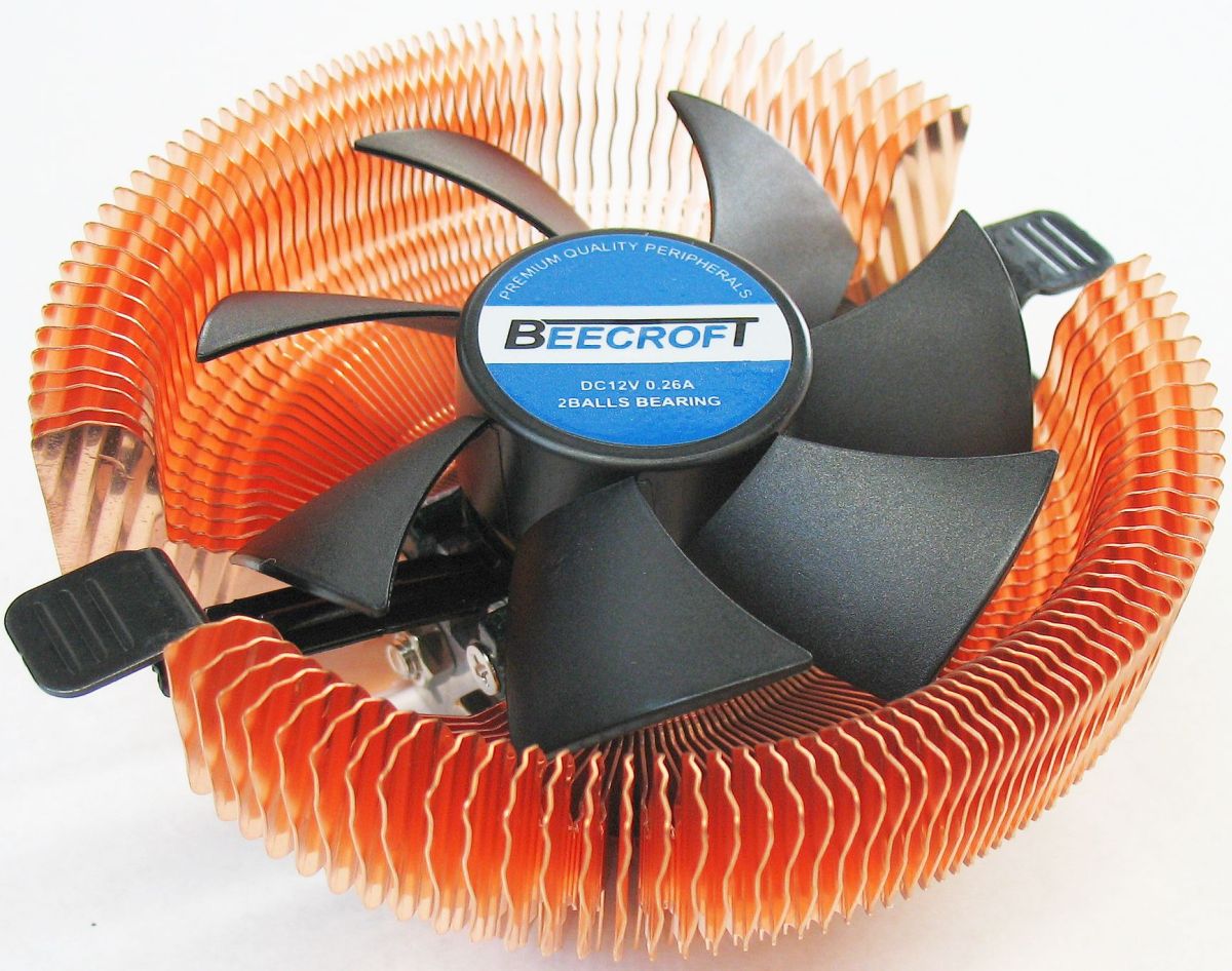

I recently put together a PC that is for general use and also the Altera and Xilinx IDE/ISE.
I used a small form factor case and now I am having trouble with thermal management. I have good graphics cards here but I am not using them because they contribute to the thermal issues and increase the load on the PSU for no real gain.
My two cents on CPU’s. Go to a CPU benchmarking site and you will see that CPU’s are no longer increasing in leaps and bounds like they once did. An older CPU with the same number of cores, same speed and a large cache can have a very similar or even higher performance benchmark to a much more modern (and much more expensive) CPU. There are some real gems in the list that are older (and cheap) chips that are up high in the list.
So the best upgrade is often just more cores and not an upgrade to a more modern chip.
My system is using a fast core 2 quad with lost of cache and has similar performance to a modern quad core.
I would imagine thermal management is also a big issue for gaming machines.
I am using a copper heat sink and a low noise case fan that will fit in a small from factor PC case. There are lots of similar ones that are useless aluminium (aluminum).
http://www.ecomputerwholesale.com.au/catalog/images/products/xlarge/fancpubeecroft92.jpg
With thermals –
Aluminum can *store* heat well but is not good at *dissipating* it so it is good where the thermal load peaks briefly but is generally fluctuating around a low average load like in an office PC. In this situation it will regulate what would otherwise be annoying audible speed transitions of the fan.
Copper can’t *store* much heat at all but it is good for dissipating it so it is good for when you have sustained high loads in performance systems.

Thermal conductivity at 25°C in W/(m K) (ability to move heat away from the CPU and internally)
Copper: 401
Aluminum: 205
Note: The efficiency of transferring heat to air is dependent on the air speed and thermal surface area and therefor dependent on thermal conductivity to transfer heat to that surface area.
The ultimate expression of complete efficiency of heat sink (and optionally fan) is degrees Celcius per watt (°C/W)
since copper is roughly three times a dense as aluminium the heat capacity of a similar sized heat sink will come out about the same. and copper has higher Thermal conductivity so it’ll more effectively more heat from the hot spot to the fins
The emissivity is radiation heat in the IR. Since the fins are facing each other, basically no effect. The contact with air will do all the heat transfer. If it was a big sheet facing the outside, then a black oxide would be a good thing.

” in moving air the probability of photons colliding with the elements of air is still the same.”
Air is pretty much transparent to the IR frequencies given off by a heatsink, at least over millimeter distances. It doesn’t absorb the radiation, and the heatsink fins are simply warming each other.
The heat transfer happens by forced convection, literally air molecules bumping against the surface. There’s a viscous boundary layer of air against the heatsink surface that resists being blown off by sticking to any roughness in the surface, and it acts as an insulator. Meanwhile any surface roughness such as from anodizing or oxidation means more heat transferring surface for the molecules to hit, which means heat is transferred more efficiently into the boundary layer.
It’s an optimization problem. Placing the heatsink fins close together and using a powerful fan forces the boundary layer to move, whereas placing the fins sparsely creates a low-friction channel in the middle that lets all the air flow through without much use, in which case the fins should be polished and smooth so the boundary layer gets picked up and along more easily.

Heat sinks don’t break laminar flow so the proportion of air molecules that “bump” into a heat sink is negligible.
I don’t remember seeing oxidised copper sinks though, they’re usually shiny and laquered.
