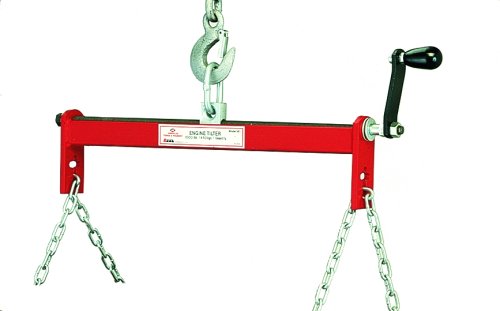

Being a 4×4 you’ll have some ‘fun’. You’ll want to remove the transfer case from the back of the transmission, which is almost always possible on 4×4 vehicles that are rear drive in their 2WD version. Then take out engine and transmission together.
Depending on the vehicle it may be possible to remove the engine from the transmission, leaving it supported on a jack. Then you won’t have to take the transfer case off the transmission.
If you can rent an engine tilter along with the crane, the job will go MUCH easier. https://images-na.ssl-images-amazon.com/images/I/313VA7FH65L.jpg

Hmmm – I am considering buying an engine hoist. Can I make a regular one work with the Feroza or am I going to have to buy a special one? Budget’s low on this build…
You could always do the cheap trick, put the Feroza on rims without tires while swappin engine.
But as mighty as the Feroza is, it is not much taller then a Mazda Miata, so do a dry run first to see if the hoist will do :D
A block and tackle can be used if you have somewhere strong to attach it overhead.
Might be out of your budget, but Hare & Forbes (Australia) have these really useful-looking mobile girder rails http://www.machineryhouse.com.au/Mobile-Girder-Rail
Much more clearance than a regular engine hoist, but pricier too.
