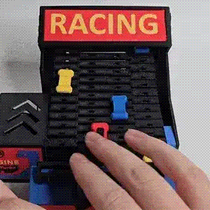

Quality 3D printing is a common hobbyist tool nowadays, and [wontonnn]’s mini arcade car racing game really shows off how 3D printing can bring parts from functional to fantastic. There are quite a few details we like in [wontonn]’s design, so let’s take a closer look.
The mini mechanical game is one of those treadmill-based car racing games in which the player navigates a little car between an onslaught of belt-borne obstacles. A little DC motor spins things up in a modular side assembly, and a hand-cranked option is available. The player’s car attaches via a magnet to a steering arm; if the player’s car gets knocked off the magnet, game over.
Treadmill belt segments print as large pre-assembled pieces, with ends that snap together without connectors. Belts like this are sometimes tricky, so this is worth keeping in mind should one ever need a similar part. Since there are no external fasteners or hardware to depend on, one could resize it easily to suit their own project purposes.
The finishing touches on the whole assembly look great. It used to be that the sort of colors and lettering seen here would come from a sticker or label, but [wontonn] gets clean lines and colors by raising (or sinking) different parts of the design. The checkerboard pattern, for example, has the light squares raised for printing in a different color.

  1. I just spent six hours on the busiest highway in North America, observing some of the most aggressive drivers. That red car is certainly either a BMW or an Audi. And its indicator lights don’t work.
    1. The orange lights at the corners of a BMW or Audi aren’t used in pairs for turning.
      They’re all used together for magically granting permission to park wherever the driver wants.

  3. Please, if designing toys or household items that incorporate magnets, design them to be fully captive. Solid print layer, print hole, pause printer, insert magnet, resume print. Epoxies, glues and interference/tight fits are not permanent. Kids swallow magnets and need life-saving surgery because the magnets perforate their gut.
  4. Looks like fun!
    Some thoughts:
    – A barrel cam with suitable gear ratio could be used for demo mode.
    – An odometer could serve as the score.
    – Split the road into separate lanes, each geared slightly differently, to make the traffic more random.
