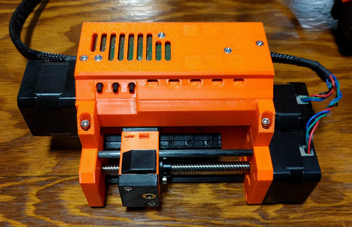

Prusa’s Latest Triumph
A while ago, Prusa introduced the multi-extrusion upgrade to the Prusa i3. It works, but there is a downside — each filament you want to multi-extrude requires a separate stepper motor. If you want four colors of filament, that’s four motors.
There’s a better way of doing things. It was announced a few weeks ago, but at MRRF we got our first look at the new multimaterial upgrade. Instead of a stepper for each different filament, this is a weird little machine that takes five filaments, selects one, and pushes it into the extruder motor on the x-carriage.
Here’s what’s going on with this new extruder. The ‘filament selector box’ — or whatever we’re calling it — consists of five holes in the back that accept different filaments, and a single hole on the front that accepts PTFE tubing that feeds right into the main extruder on the x-carriage. In between the front and the back, the filament feeds through a series of rollers that selectively feed filament to the front. When the printer wants to change filament, the movable carriage on the front moves from one output to the other. Filament is automatically sliced inside the machine. Think of it as a printer-mounted version of the filament-slicing robots we saw this weekend, only very much cheaper and significantly more clever.
The entire contraption is driven by a small board with three motor drivers. This is the Prusaino, and will make a great CNC controller when it’s sold by itself.
This is a fantastic advancement in the state of multimaterial printing. It’s not shipping yet, but we can’t wait to get our hands on this thing.

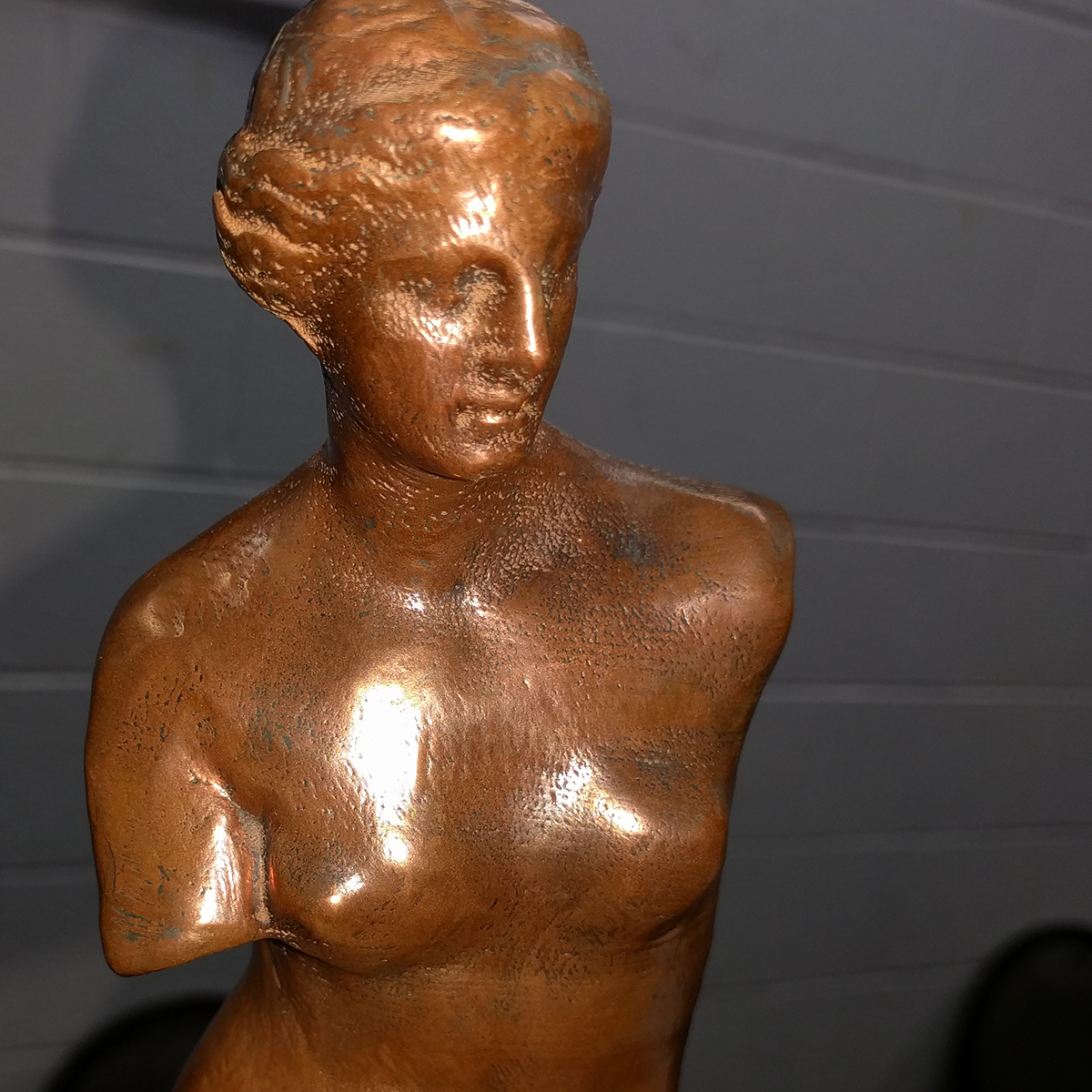

High Metal Content Filament
Metal filament, or PLA that has a bit of tiny metal particles embedded inside, has been around for a while. If your prints are very good, you can smooth them to a high shine. The metal content of these filaments hover around 60-70%. It’s good, it’s heavy, but here’s some filament with a metal content of 80%. Yes, there is a difference, and this filament is worth the price.
This filament comes from The Virtual Foundry, and pictures will never do it justice. This feels like real metal. It is as if these objects were cast in bronze and plated with copper or stainless steel. The specs for the 316L Stainless filament give it a density of 4.05, a metal content of 81%, and it prints well at 210C. This is the greatest metal filament I’ve ever seen, and if you throw an object printed in this into a kiln, it comes out as a solid metal object.
How much does it cost? $100 for a kilogram of the copper filament. Keep in mind it’s significantly heavier than regular ‘ol PLA.

so when is Prusa releasing this new multi-material upgrade ?
also, i’m betting in all those pictures of metal prints, the objects have been post processed, sanded and possibly electro-plated.
nope they are sintered in a kiln
impressive results, though a kiln is a bit much to get for me personally. still better than the nasty chemicals you need for electro-plating..
also, i bet there’s a reason i only see pictures of artistic objects, and no accurate mechanical parts..
They said it doesn’t shrink much when you fire it, but everything shrinks when you fire it. I suppose you could figure it out and adjust your prints accordingly, but it would be stupid expensive figuring it out!
As soon as the PLA containing the metal particles melts doesn’t the whole thing become super soft and just deform when fired?
If you already have a kiln you’ll be better off just making a mold out of silicone from your 3d printed part and pouring some metal in it. That will not have any shrinkage. So this filament is more for fun than actual mechanical parts.
It still shrinks. I’ve done foundry work in aluminum, and the temperature drop from the melting point to room temperature will cause aluminum to lose about 3/32″ per foot in my experience. That’s quite a bit — enough that you need to compensate in the pattern. Some parts also have uneven shrinkage, called “camber.” http://engineeringhut.blogspot.com/2010/11/pattern-and-its-types.html

I got a few samples of the VirtualFoundry material over the weekend. However, I believe there is a bit of sleight of hand going on here. If you read their documentation on their site (what little amount there is), it states a 90%+ metal content. Their printed samples, particularly the stainless prints, looked fantastic, with a bright, high polish. I am guessing these were done with a 90%+ content material, whereas the stuff they were selling (and what I have) is 81%. I have printed a few objects with the stainless since Saturday. It will not polish to the bright, nearly mirror like polish. It will get a very gray, reflective shine, but nowhere near the bright polish they had on their examples. I have been using metal filled materials for years, primarily ProtoPasta, as well as polishing said materials for years, I know how its done. As it stands, for the expense , this stuff (81% content stainless) is absolutely no better than ProtoPasta, It prints the same (quite well) , it polishes the same , looks the same, and the end product feels the same. Dont waste your money on this stuff yet until we can figure out what the deal is. Just grab some ProtoPasta for now if you want to try a high content metal material.
Isn’t their trick in making it look nice to burn out the plastic in a kiln?
You gave up too soon, or didn’t do the preliminary work. Sand with increasingly fine grits of sandpaper. Our prop makers get that final luster with a cotton buffing wheel and a buffing compound like Zam or Fabuloso. Standard Jewelers Rouge will do in a pinch though.
It’s the same process we use with our lost wax bronze castings, just use a lighter touch.
LOL, yup, done all that using the same materials. Cut down to 8000 grit micromesh even, and polished with a cotton loose stitched buff with Zam on a professional jewelers polishing machine. I think I DID mention in the post that I have been doing this for a long time. I mean, I have probably 30+ years polishing various materials. It may be the technique, but my experience polishing various materials, as well as “metal filament” , says otherwise.
