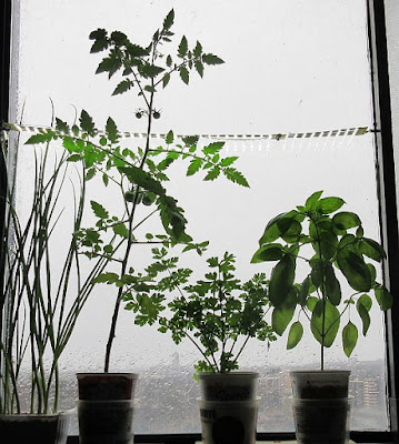

I have a few plants in undersized containers to fit my window silt. I was late by a few hours a couple of times and the plants weren’t too happy but they adapted. They seem to be doing okay with their daily measured amount of water even in the very dry winter. Right now they get their supplement of winter sun light from LED strips. I’ll automate the watering when the pump and other parts arrive.
Daily?! That’s quite a luxury. Mine have to accept irregular watering, roughly weekly.
s/weekly/weakly
B^)
There was limited depth of the window silt, so I have to use yogurt containers (650-750ml). So there was little soil to hold enough water for more than a day. The plants have decided not to let that limits their growth anyway.
https://2.bp.blogspot.com/-DQ_VIPbTJCg/W2CfFZnyIcI/AAAAAAAAB4E/b51hDVR2K-8j9cZTzM-QlN3g_VaF2TG0wCLcBGAs/s400/2838051523816142417.jpg
That cherry tomato plant grew to 3 feet tall before I gave it away.
