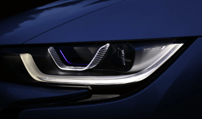

Laser headlights were first announced by BMW in 2013, with the German company promising the technology would be available on its new halo car, the i8. Fellow German rivals Audi would end up pipping the Bavarians to the punch, launching the limited-production Audi R8 LMX with laser headlights just months before the i8 entered production. Both brands would later bring the technology to a range of luxury models, including sedans and SUVs.
Long-throw laser lights became an option on premium Audi and BMW vehicles. Credit: Audi
The prime selling point of laser headlights was that they could project a very bright, very focused beam a long way down the road. As we’ve explored previously, they achieved this by using blue lasers to illuminate yellow phosphors, creating a vibrant white light that could be bounced off a reflector and directed up to 600 m ahead of the vehicle. They weren’t so useful for low-beams, with that duty usually passed off to LEDs. However, they were perfect to serve as an ultra-efficient long-throw high beam that wouldn’t disrupt other road users, albeit with the aid of steerable headlamp assemblies and camera-based tracking systems.
Laser headlights were more expensive to produce, but were also far more capable than any conventional bulb in terms of throw distance. They were also more compact than just about any other automotive lighting technology, giving automotive designers far more freedom when creating a car’s front end. They were even able to outperform LEDs in the efficiency stakes. And yet, both Audi and BMW would come to abandon the technology.

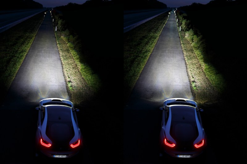

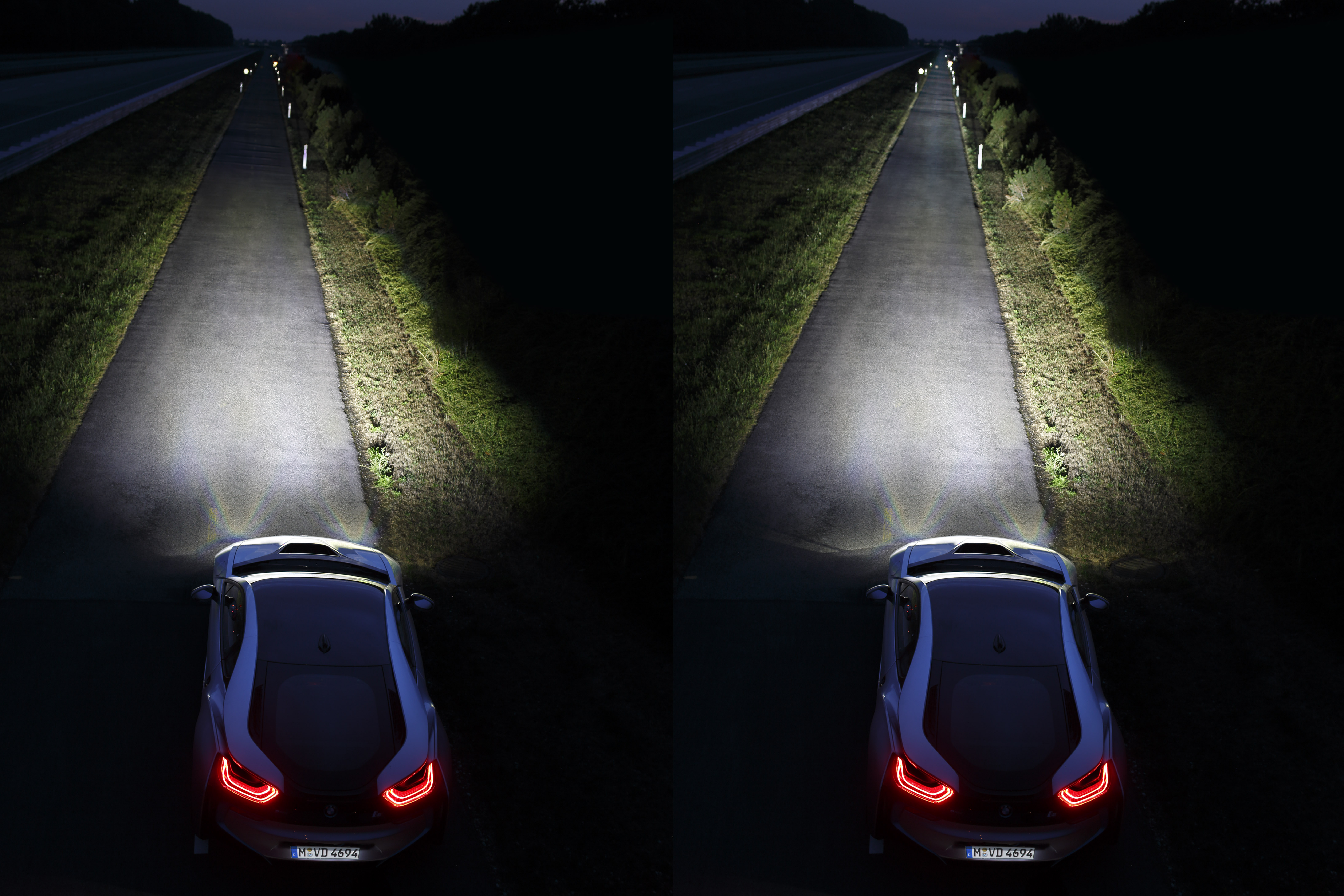

A comparison from 2014 between BMW’s LED high beam (left) and laser high beam (right). Notice the far greater throw of the laser high beam. Credit: BMW
The culprit? Regulations. In particular, headlight rules enforced in the United States. The Federal Motor Vehicle Safety Standard rule 108 deems that headlight intensity must not exceed 150,000 candela, while beam range must not exceed 250 meters. These rules effectively mean that laser headlights can’t outperform older technologies without falling afoul of US regulations. The rules stand in stark contrast to European regulations, which allow headlights to reach up to 430,000 candela. In an echo of the sealed beam era, US regulations were once again stymying European innovation by being firmly stuck in the past.

  25. I call bullshit on that so-called comparison photo. Same car (look at the reg plate), same position (look at the grass), same lens pattern on the road (look immediately in front of the car).
    Surely BMW can afford something better than a marketing trainee with Photoshop for this sort of thing?
