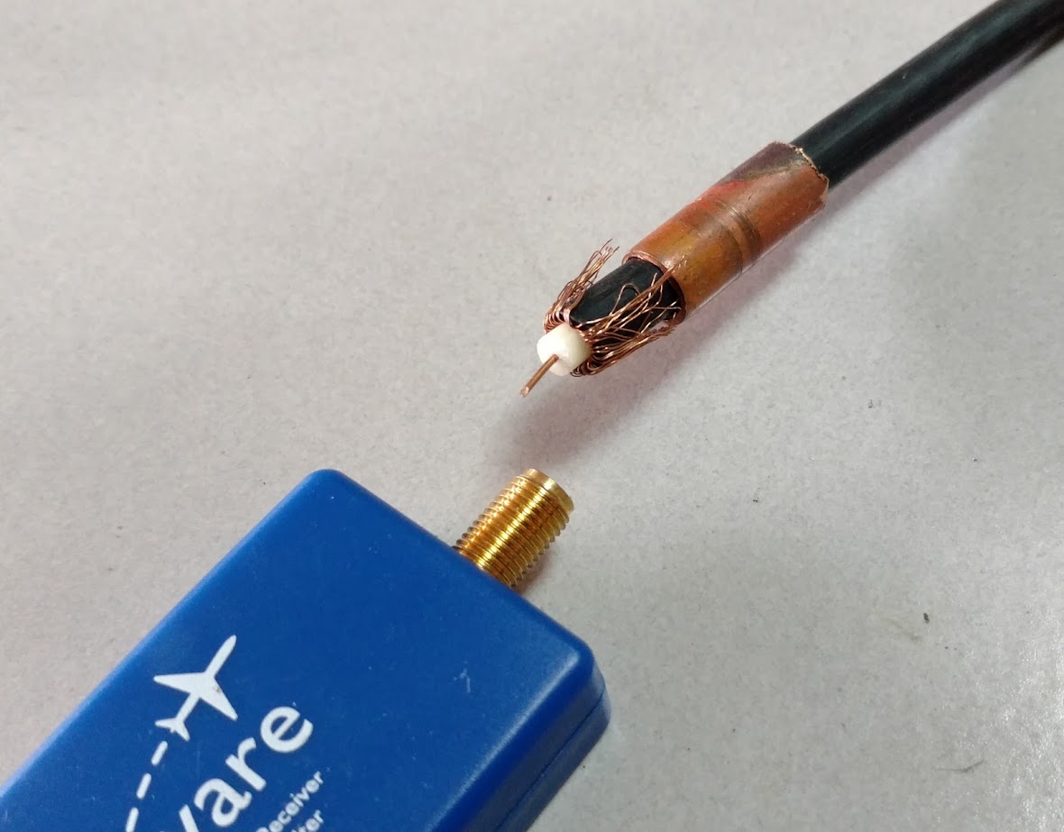

  14. Last year I made an external franklin dipole antenna to extend the range of my then new ADSB SDR receiver. I couldn’t find in my backwoods the N male connector required by the SDR dongle, so I made a “temporary” one with a 15mm of common 1/4″ copper tubing, which ID happened to fit the OD of the coax plus shielding.
    Saw planes at the theoretical maximun of about 350Km. Will not even touch the “connector”.
    http://tinyurl.com/y72kc9gv
