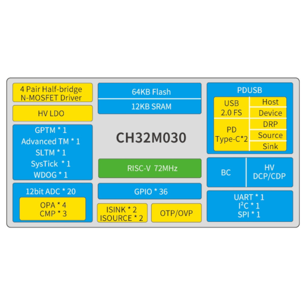

All of which brings us to the WCH CH32M030, a chip that’s been on the radar for a while and has finally broken cover. It’s the CH32 RISC-V microcontroller you may be familiar with, but with a set of four half-bridge drivers on board for running motors. A handy, cheap, and very smart motor controller, if you will.

    The hbridge in the silicon is interesting but surely it can’t manage much switching?
    I can’t imagine what a good usecase would be other than some very small motors.
    1. If you’re trying to run large motors, then you’re almost certainly in an application where there’s plenty of room to also put in large electronics.
      Chips like this are specifically for tiny applications with equally tiny size constraints.
      1. This. The chip only includes gate drivers, not FETs. There are some other very interesting peripherals, too. There are two small-signal amplifiers with digital filters (for SDR), dual programmable current sinks and dual programmable current sources, USB full-speed host and device, USB PD controller… I love these WCH chips!
          1. That makes perfect sense!!
            And all good points yes I was imagining someone running a tumble dryer off this.
          2. The CH32M007 would probably be better for that.
            It has 3 half-bridge drivers instead of 4.
            And it doesn’t have usb or power delivery which would be overkill for an esc.
            It does run a bit slower 48 MHz instead of 72 MHz.

      1. ST has STSPIN32 series that started in 2020, its basically variant of STM32 (from various lines) with gate drivers built in one chip. you can get them rated up to 600V, with CORDIC (math functions eg trigonometry accelerator) and CAN.
        though ST chips are more pricey and lack HV regulator so they arent “make quadcopter as cheap as possible” optimized chips.
        Inifneon has similar MOTIX series of MCU with drivers built in.
        Not that familiar with rest of vendors you listed
        1. STspin does have a high voltage SMPS built in. It goes upto 50V or so. It also as analog opamps to amplify the voltage from the shunt resistors. I thought about building a design around this chip, but that was a few years ago and the whole semiconductor industry was such a big mess during covid that I decided to ignore such specialized IC’s altogether.
          STspin does only have 3 half bridge drivers. That makes it more difficult to make a closed loop stepper motor driver with it. 3 phase stepper motors are a bit uncommon, (Although they do exist, and are not exceptionally rare).

    1. Better yet, find a chip that has all three within the same die, low-power RISC-V, bunch of CPLDs ready to boot AND small-ish (but usable) FPGA. WiFi can be left out to be handled by ESPC3/6 outside of the die (and easily controllable – turned on and off when/if needed).
      This chip finally has 4 OpAms together with 3 CPD for the quadrature detection, which is mighty nice, but we need moar, say 16 OpAmps for things like massive parallel differential computations without the code.

  5. I like the idea of motor drivers baked in. Alot of my projects don’t do a lot except step two motors and read a few analog pins. Seems like a good way to save some money.
  6. Nowhere on this page, or the linked pages can I find how many Amps those h-bridge drivers can handle. And that figure really is one of the most critical ones for knowing how suitable this chip actually is for any given application.
    1. In the datasheet under absolute maximum ratings it states +-80mA for:
      “Sink current or source current on MV pre-drive I/O pins”
