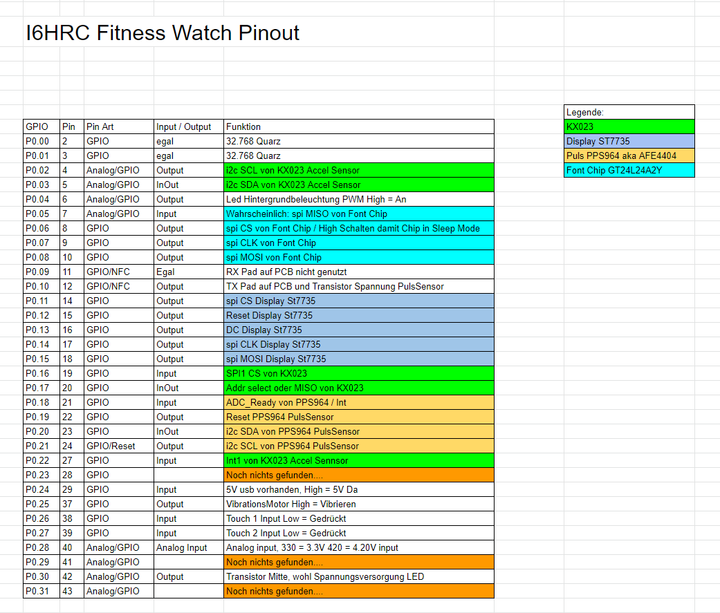

Hi Aaron, about the I6HRC – the swd pins are on usb data pins by default so it is flashable without opening it or is this your hack to connect it there after opening it? I dont see the connections anywhere on the photos.
What nordic softdevice/SDK version is there by default? Can you read original firmware via SWD or the flash is protected? Can the display be updated directly without using that font chip (why it is there anyway?). Thanks.
Hi, unfortunatly the SWD pins are not connected by default, there are testpads on the pcb labeld as clk and dio and you have to connect so called kupferlackdraht to the usb D pins. It is hard to make a picture of it because it is behind the display.
I don’t know the original softdevice. nRFgo just says it is unknown with the id 0x0091 and a size of 124kb so maybe custom. also a 32Kb bootloader and 356kb Application.
I was able to read the Original firmware but when i tried to flash it again i doesnt boot anymore. via IDA it is readable, also i have the update file of the firmware but without bootloader and flashdevice.

Hi Aaron,
Great work there. I got myself one of the I6HRC and managed to take it apart to change the firmware. I am trying to program it directly using Nordic SDK on Segger Embedded Studio. I got the pin reference from the forum post here:
https://www.mikrocontroller.net/topic/467136#5736478
I am able to turn on the motor, communicate with the accelerometer. However, I just cannot get something to display on the screen. The backlight is not turning on at all. Is there a pin the controls the backlight or turns on the LCD? Is it P0.30? I tried to set it to high, but nothing happens.
Hi, you got the wrong pinout i think.
Here is the right one for the I6HRC Tracker: https://3.bp.blogspot.com/-B73B3j4p0xA/XGWlEig825I/AAAAAAAAOJY/lcm7oOiu2YMoiavg4rRuX7OHaLP6cCYtgCLcBGAs/s1600/Pinout_neu_30.01.19.png
You Are kind of right. the “Master Power pin is P0.30 for the overall power supply and the Backlight Driver pin is P0.04 you need to set P0.30 high and then you can set P0.04 high or give out a PWM signal. bedder is PWM because on full backlight it takes about 20mA
Have a nice day.
Thanks Aaron for the quick reply. I will try it out soon. I was looking at the same pin out table, its just that I couldn’t understand what language it is (German?).
So now I understand that P0.04 is to turn on the LCD backlight. But I am confuse about the function of P0.30. When you say master power, do you mean P0.30 controls power to the LCD, Heart rate monitor, accelerometer etc?
Unfortunately i haven’t really figured it out what P0.30 really does, Display sensor is still working without it. you have to turn it on for the back-light.
Maybe the light sensor is on it.
In every sketch i turn the P0.30 on when the MCU comes out of the sleep mode.
