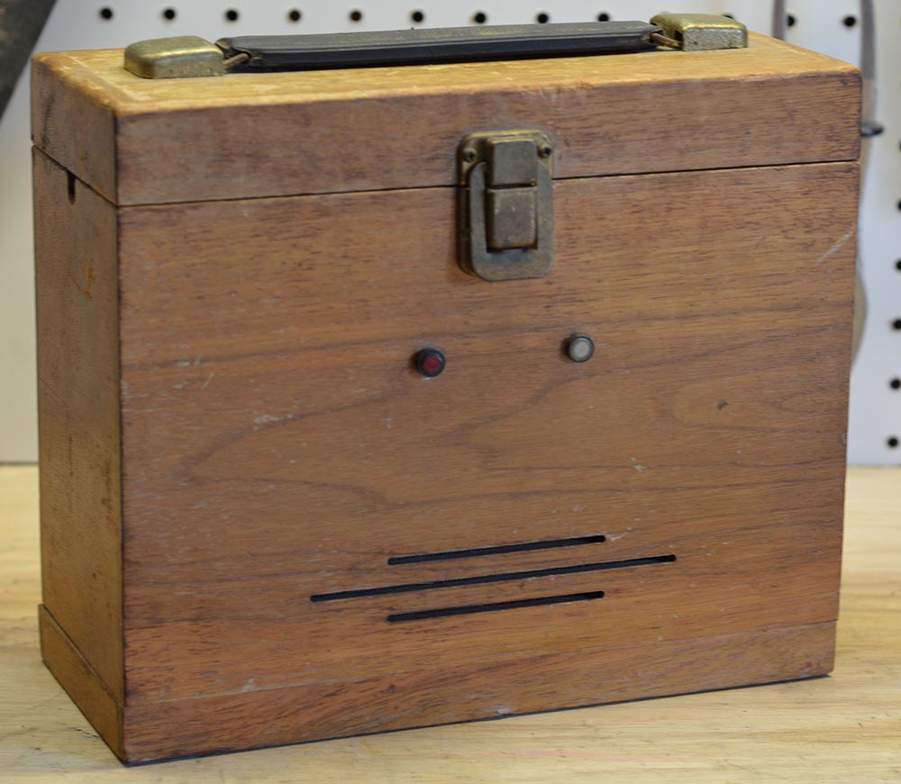

A few years ago, I was out at the W6TRW swap meet at the parking lot of Northrop Grumman in Redondo Beach, California. Tucked away between TVs shaped like polar bears and an infinite variety of cell phone chargers and wall warts was a small wooden box. There was a latch, a wooden handle, and on the side a DB-25 port. There was a switch for half duplex and full duplex. I knew what this was. This was a modem. A wooden modem. Specifically, a Livermore Data Systems acoustically coupled modem from 1965 or thereabouts.

This leaves an ancient modem like the one sitting on my desk in an odd position in history. It was designed, marketed and sold before the Carterphone decision, and thus could not connect directly to AT&T’s network. It was engineered before many of the integrated chips we take for granted were rendered in silicon. The first version of this modem was introduced only a year or so after the Bell 103 modem, the first commercially available modem, and is an excellent example of what can be done with thirteen or so transistors. It’s time for the teardown, so let’s dig in.

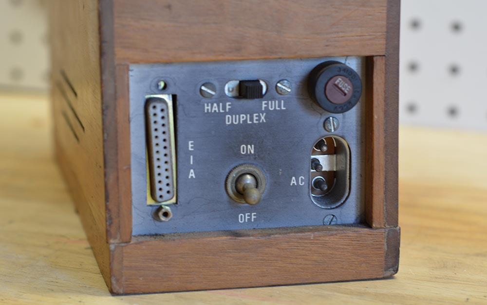

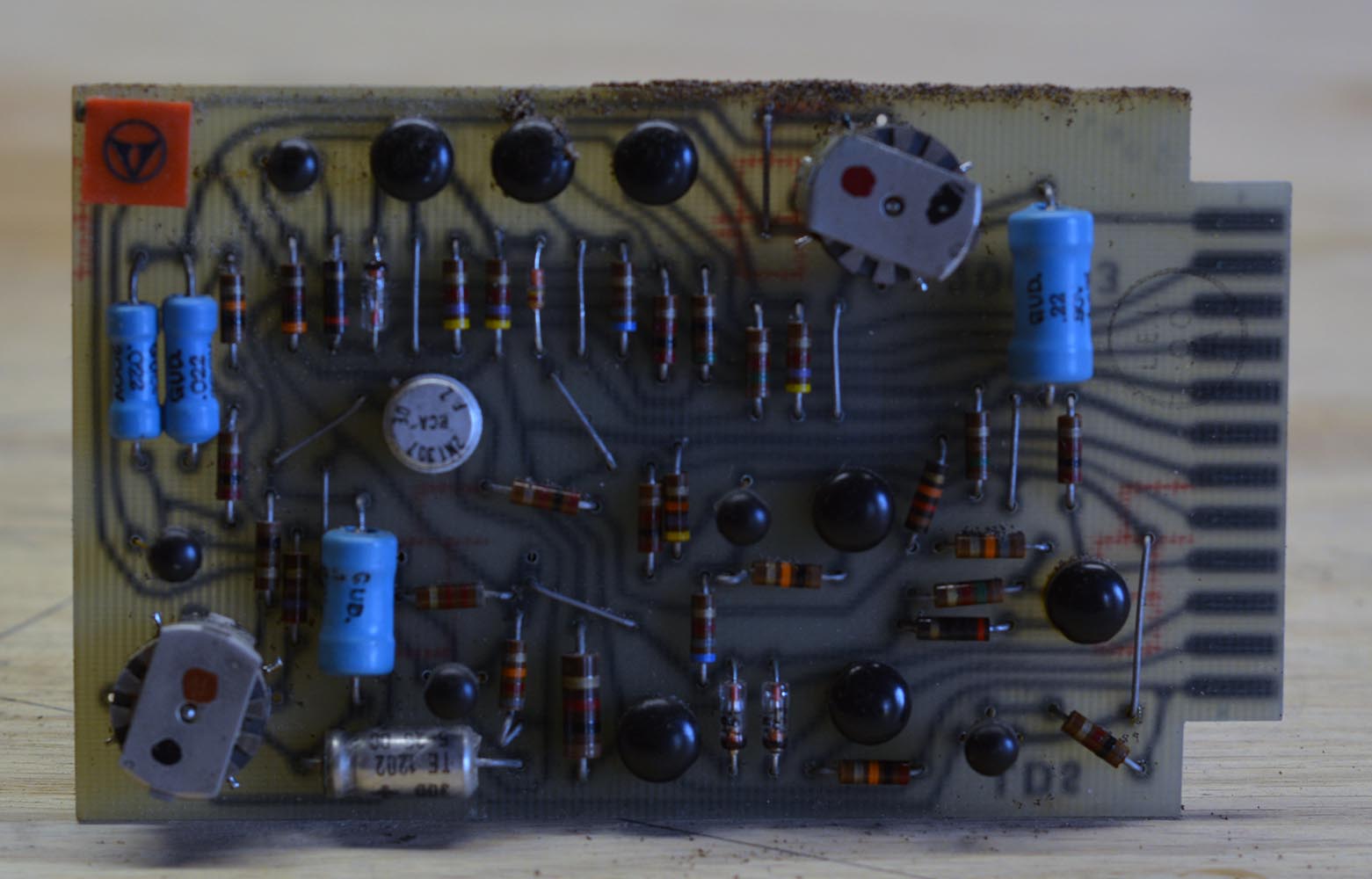

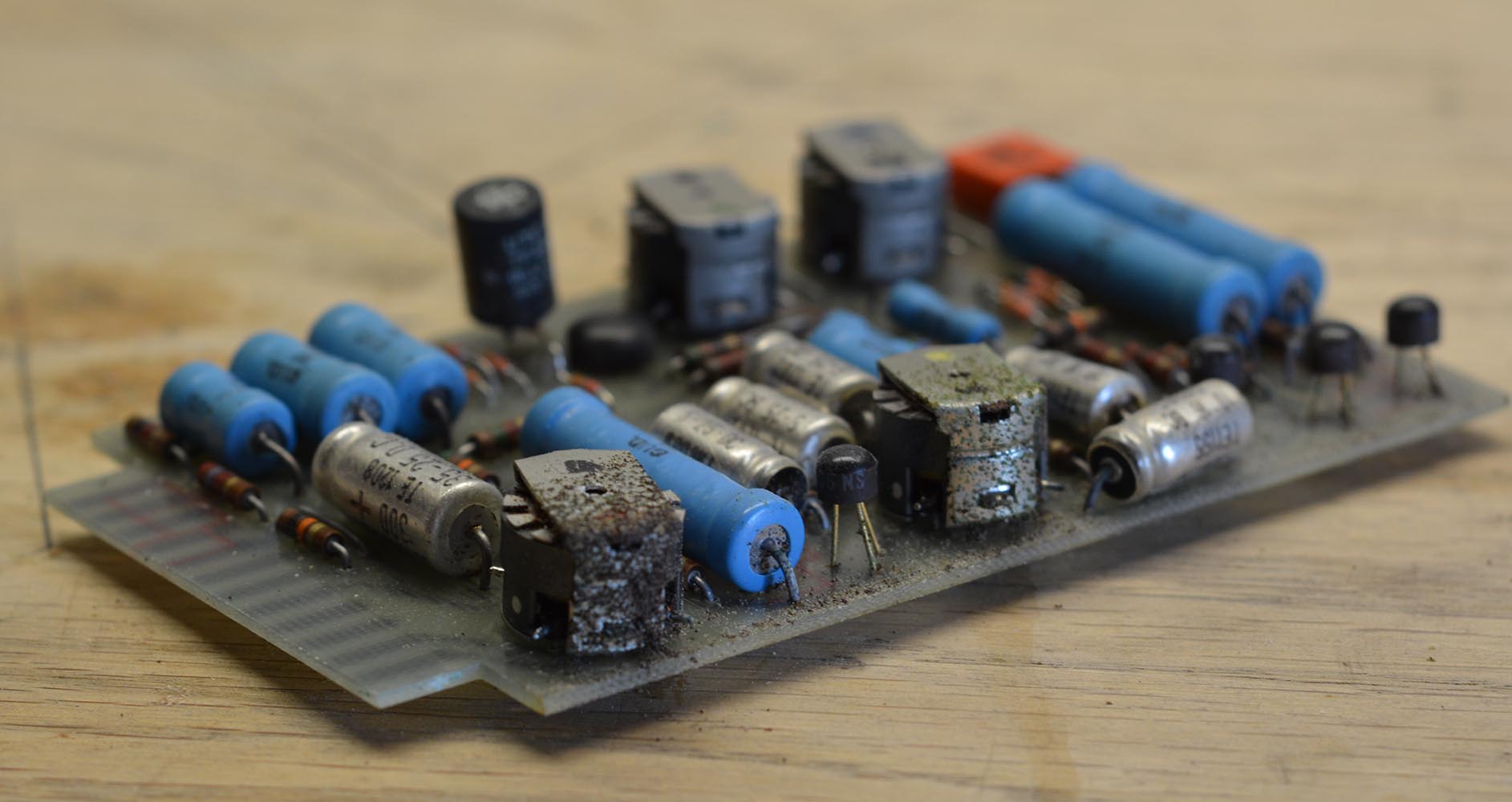

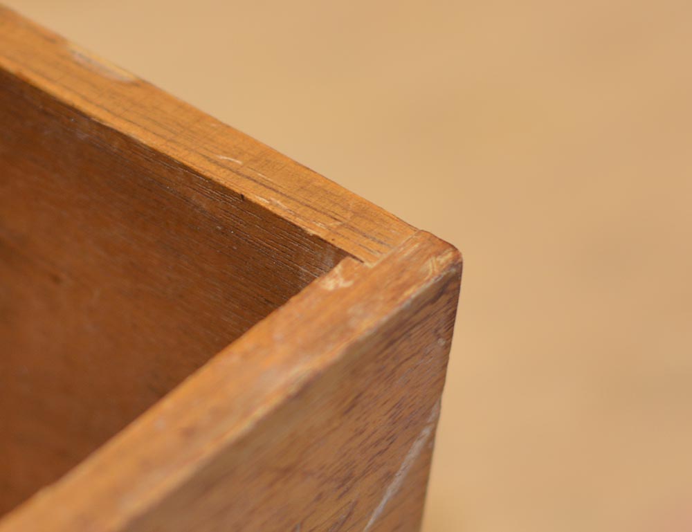

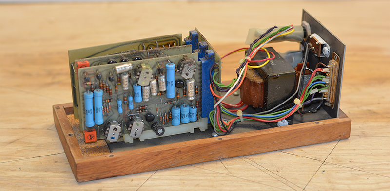

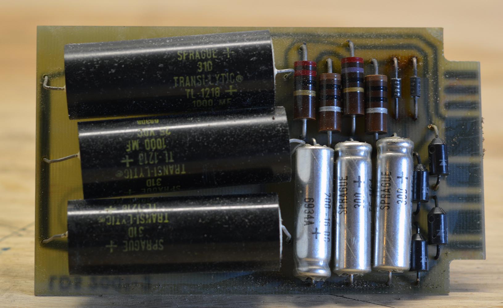

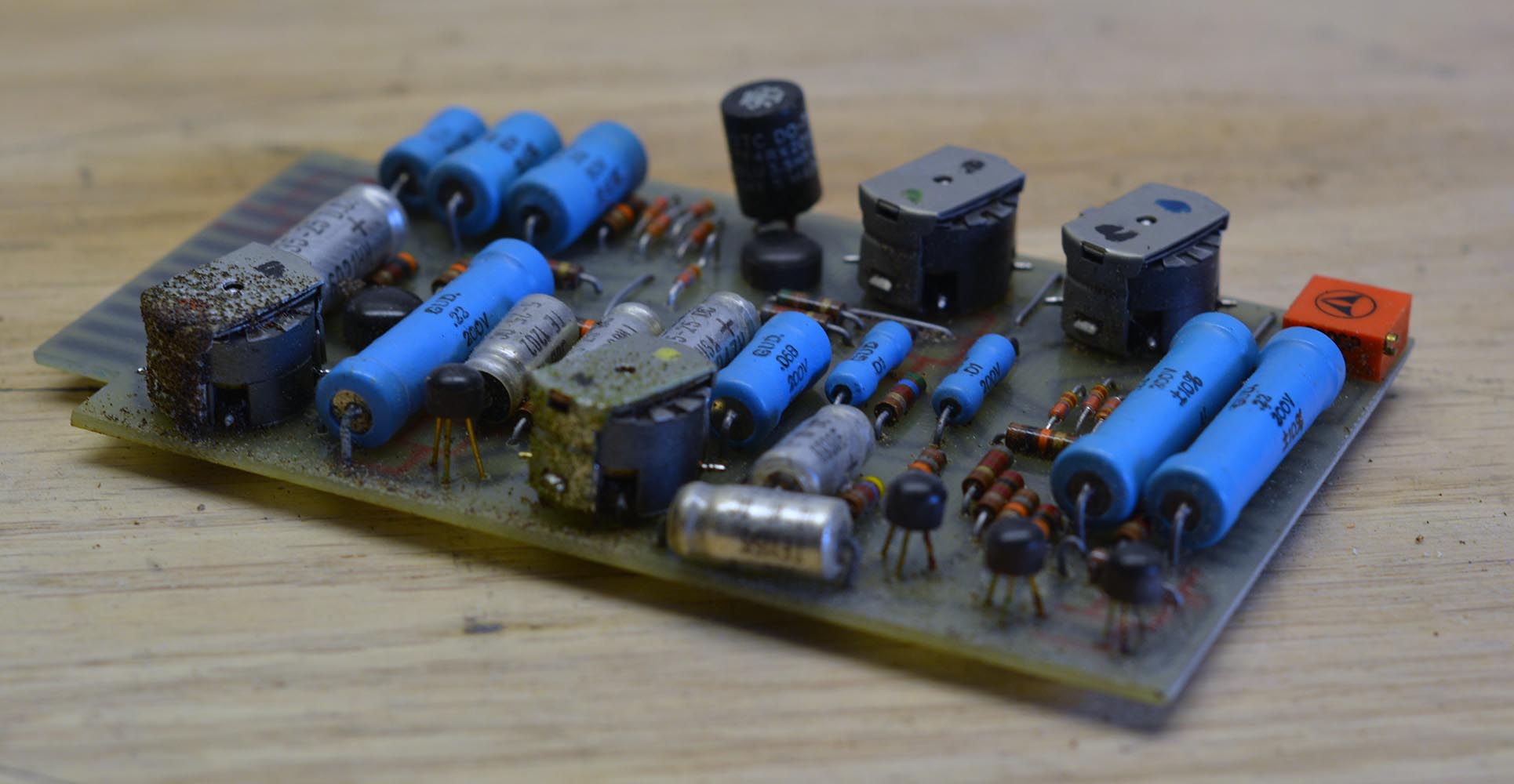

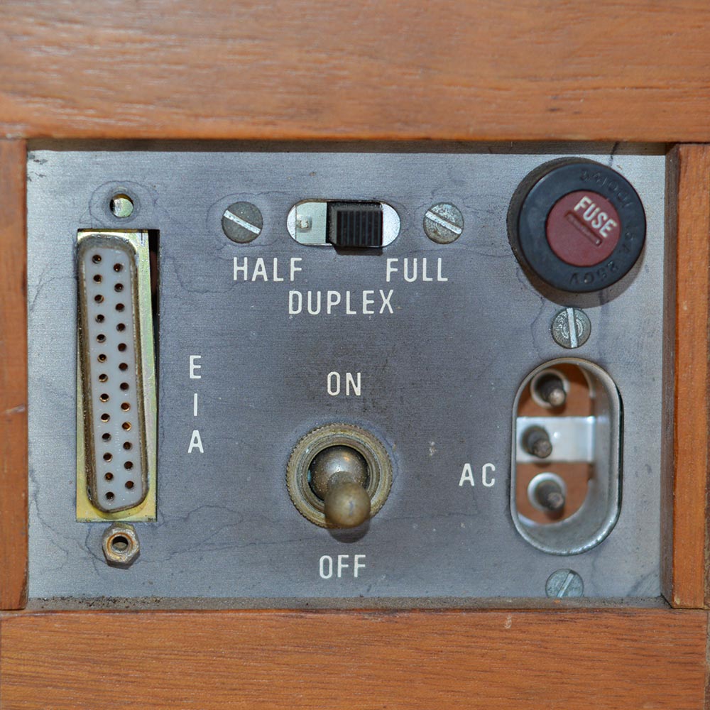

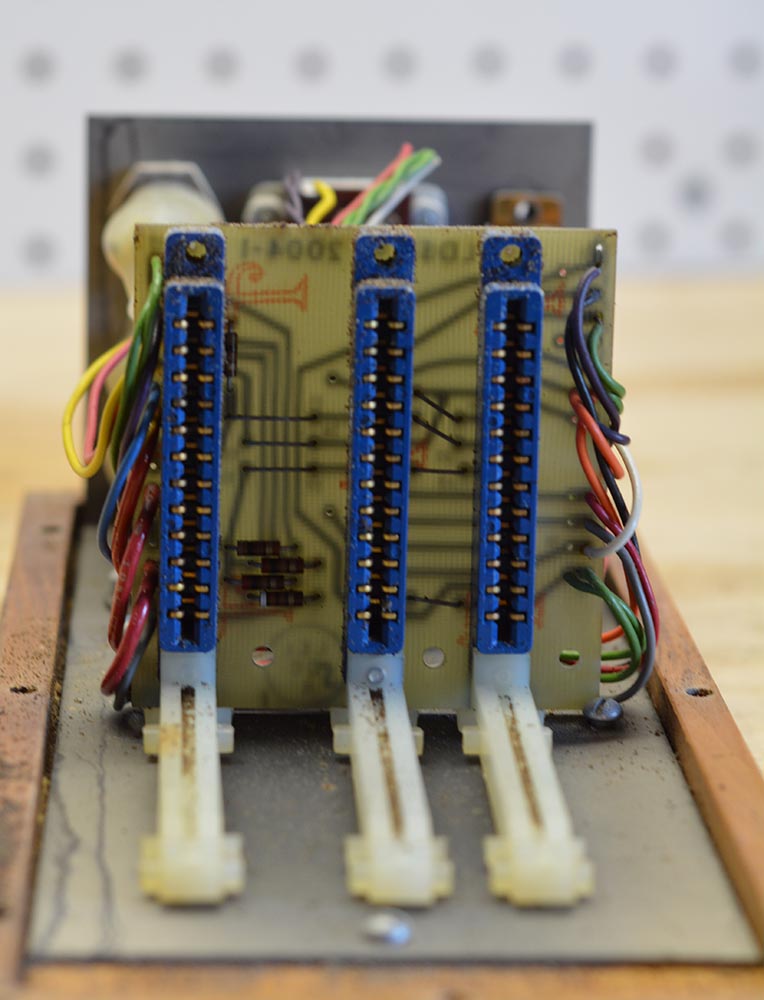

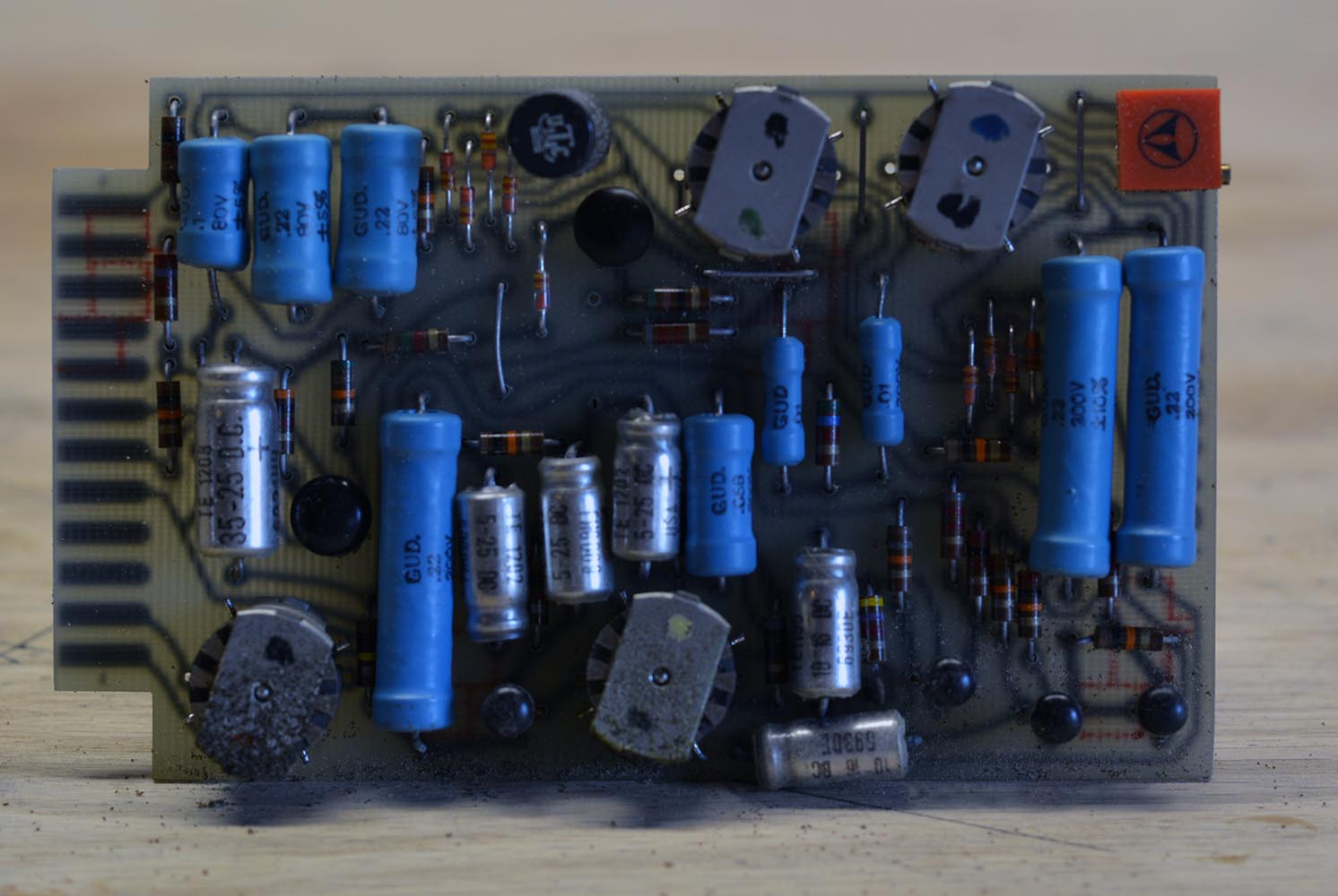

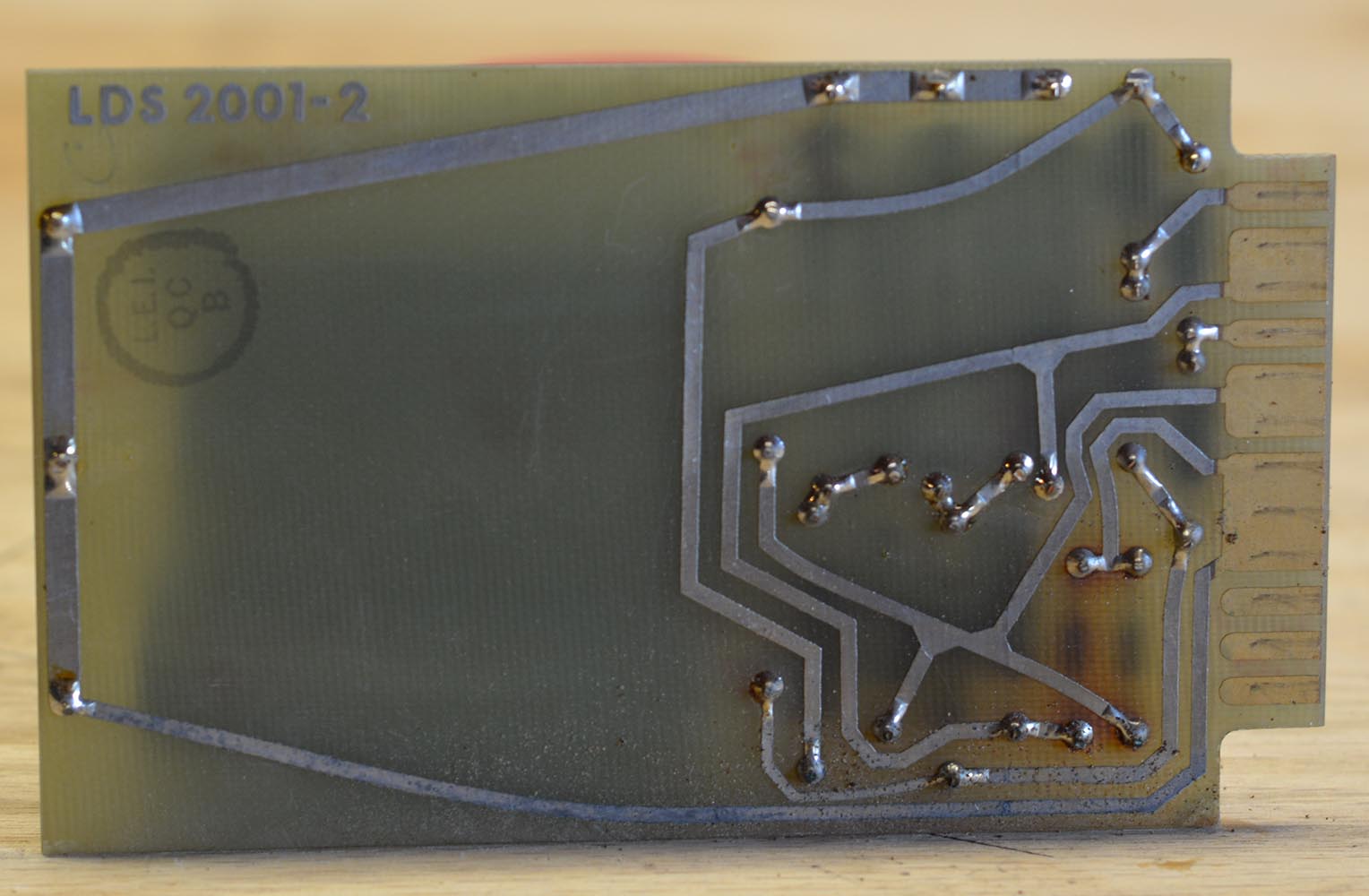

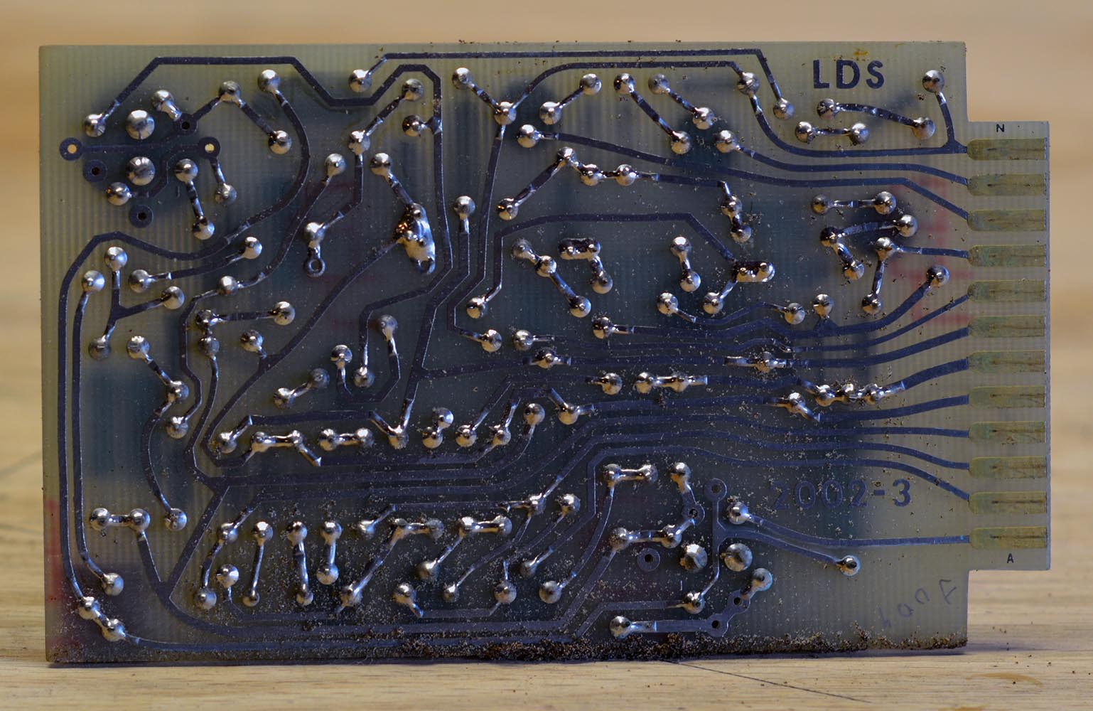

The Actual Teardown
Apart from the lack of an acoustic coupler, this modem is more or less exactly what the documentation and references told me. There is a backplane of sorts, holding three cards. One card holds the power supply (less transformer), another card holds the modulator, and another holds the demodulator. The transistor date codes, specifically for the 2n5138 transistors are from the 37th week of 1969. Nice. This puts the date of manufacture for the transistors in September of 1969, and the date of manufacture sometime after that. Unfortunately, there’s no way of narrowing down the vintage of this modem any further, but it’s entirely possible it was built and shipped before 1970.
Is This Thing Worth Repairing?
My initial draw to this modem finding it at a ham swap meet was simply to own it. It’s a wooden modem, and I don’t think anyone I know respects exactly how cool that is. It’s on objet d’art, and it’s useful to store various sundries. I have considered repairing or refurbishing this modem, however there are a few things that make this impractical.
First, there is no acoustic coupler. This, I believe, is the reason why no one at the swap meet realized what it was. The Livermore Data Systems emblem and serial number was also adhered to the acoustic coupler, and without that, you would really have no idea what you were looking at unless you had an intimate knowledge of the garbage pile of a warehouse in a vintage computer museum. But I could easily 3D print an acoustic coupler, and that might be tempting.
Secondly, this modem is completely untested and half a century old. I guarantee the caps will need to be replaced, and the carbon composition caps are out of spec. I would need to reengineer the entire device to repair it, and there are better things I could do if I wanted to make my own modem.
Finally, if I wanted to engineer my own modem, I could just build a data toilet. This is a German / Chaos Computer Club project from 1985, built in response to modems being highly regulated by the Deutsche Bundespost. From a design standpoint, the data toilet is much simpler and much more capable. It’s built around an AM7910 chip that supports up to 1200 baud, and these chips are somehow still available from the usual online retailers. If I wanted to build a modem from scratch, this is how I would do it, not with discrete transistors.
Unfortunately, it’s just not worth the time to repair this ancient wooden modem, but a good teardown does give some great insight into how things were built before there were integrated circuits in everything. It’s an object of curiosity, or at least it is until I can find an acoustic coupler for it.

I have a really hard time believing no one else knew what this was. The combination of the full/half duplex switch and the DB25 connector simply scream ‘modem’ to anyone with a comms background, surely?
Well, without the acoustic coupler (and attached label) I’d guess it was modem by the Full/Half Duplex switch.
But, I wouldn’t be certain it was one.

Strange that the made they made the PCBs symmetrical. I can’t see anything that would prevent putting in the PCBs upside-down and the single-sideded PCB would still make contact with the other side of the connector, but in reverse pin order….
These weren’t meant to be user-serviceable, but in any case, what prevented putting the PCBs in upside-down was training and inspection.
Believe it or not, they used to make symmetrical integrated circuits, too (dual-inline packages), and those really WERE a hazard, especially when socketed, since the user COULD do something stupid.
The obvious question would be, why did the sockets have contacts on both sides?

Dovetails didn’t have to be labor intensive, even in the 60’s, if they had access to one of these:
https://woodgears.ca/machinery/dovetailer.html

You say the wooden case is walnut but it sure looks like oak to me
