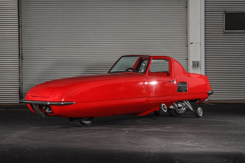

The prototype was up and running by 1967, and appeared at the International Automobile show in New York. The magazine Science & Mechanics featured it in their September 1967 issue.
The Gyro-X proves that it’s possible to design an economy car without sacrificing a shred of speed or style. It could do 120 MPH with only an 80-horsepower Mini Cooper engine mounted in the back. It turned like a motorcycle, but with no leaning necessary — just turn the wheel and the gyro leans the car for you. When it was time to park, outrigger training wheels dropped down to keep it from falling over.
At just 42″ wide, two cars could fit side by side in the same lane, as dangerous as that sounds. Just before the company went under, Tremulis was working on a family version that was a whole foot wider and three feet longer — a real grocery-getter.

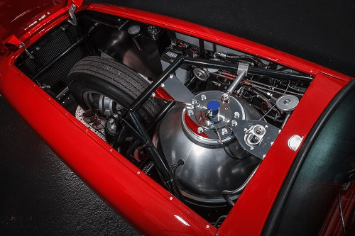

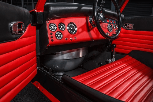

Of course, the real feature is the gyroscope that made this tiny two-wheeler possible in the first place. The 22″ diameter gyro sat in front, mere inches from the driver’s kneecaps.
When the car is driving in a straight line, the gyro makes micro adjustments to keep it upright. As the steering wheel is turned in either direction, the gyro moves in unison with the front wheel.
The gyroscope was hydraulically driven off the motor, and it took three full minutes to wind its way up to 6,000 RPM, so it’s not intended for quick getaways. But the gyro would keep spinning for about two hours after the car shut off. Perhaps that energy could have been used to charge a generator for an electric motor, or a battery for charging electronic devices.

The only Gyro-X ever produced became the custody of Thomas Summers. By 1975, he had turned it into a three-wheeler and put a Volkswagen engine in the back so he could license it in California.
It disappeared for a while and resurfaced in 1994, when a Las Vegas musician named John Windsor obtained it as payment for a debt. The car was nearly unrecognizable, and the gyro itself was long gone.
Windsor put up a video in 2009 giving a tour of the car and explaining how he came to own it. He didn’t know what he had, and so he used the internet to spread the word. It worked. The video got a bite, and Windsor sold it to a private collector, who may have bitten off more than they could chew.
In 2011, Jeff Lane, founder and director of the Lane Motor Museum in Nashville, Tennessee bought it from the collector and started pushing the Gyro-X down the road to restoration. Lane and his crew painstakingly restored it from photos and a few known measurements, an effort that took several years and around half a million dollars. The hardest part was, of course, replacing the gyro. You can’t just find those things, not at that scale. Lane hired an Italian firm specializing in yacht-stabilizing technology to make a new gyro, and that required them to fly someone out to do digital scans of the car.
Here is a brief documentary about the restoration effort, which was filmed somewhere in the middle of the process. Below are images of the fully-restored Gyro-X, all courtesy of the Lane Motor Museum. After that, we’ve embedded some vintage footage of it whizzing around Southern California.

A gyroscope has the unfortunate effect of re-directing any force by 90 degrees rotation – so if the gyro-car hits a pothole or attempts to climb up or down a ramp, the gyroscope will cause it to bank to the side.
That effect is probably what cause the instability above 70 mph. When the car goes up and down natural gradients along the road at enough speed, the pitching rate is enough to cause a banking motion that the control mechanism can’t compensate, and the whole thing starts to wobble dangerously.
