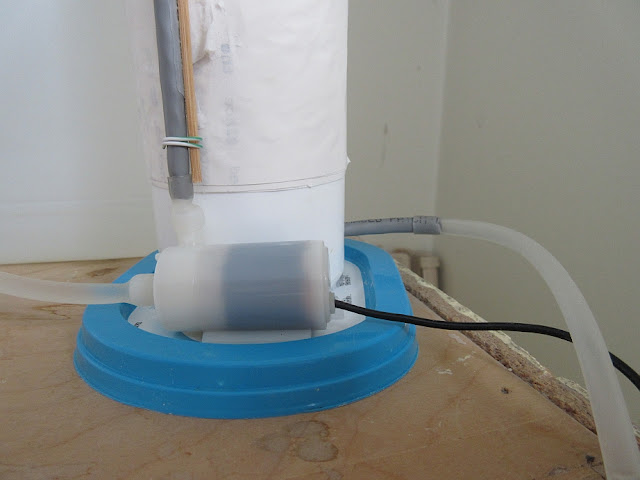

[ASCAS] took up the challenge and built a cheap and simple dispenser that relies on recycled parts and essential electronics. It uses an IR proximity sensor module to detect dirty digits, and a small submersible pump to push isopropyl alcohol, sanitizer, or soap up to your hovering hand. The power comes from a sacrificial USB cable and is switched through a transistor, so it could be plugged into the wall or a portable power pack.

Have you opened one up? I would think they use very cheap brushed motors….
Considering the pump is less than $1 (I paid $0.86+shipping) , you won’t get anything fancy.
That particular pump used by OP uses brush motor and is not water tight. For this project, probably okay.
https://1.bp.blogspot.com/-sJTmqgivw2A/XnAFpwfaQEI/AAAAAAAADPU/hCfhuB2YgnAqkiZ8t5PfEVh2tz1Jnyp-gCLcBGAsYHQ/s640/IMG_2682.JPG
see the dark brownish motor vs OP. Mine has rust and the motor no longer works at the rated voltage. It needs 20V to break off the rust to start. Mine also had a leak on arrival that I seal up with superglue.
There are different types of pumps that do not submerge the motor, but this one was the cheapest. My replacements are probably stuck because of virus lock down.
